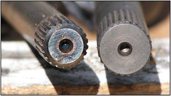

at the end of shaft/spline there is countersink,,it is important?

So you're asking about the countersunk hole at the end of the splined shaft? It obviously serves a purpose, otherwise the manufacturer wouldn't have bothered machining it. Is there a spigot in the mating part which interacts with this?

That little dimple in the end of the shaft is called a centering index. It's used to center the shaft in the machine that makes it. It serves no purpose once the part is completely machined.

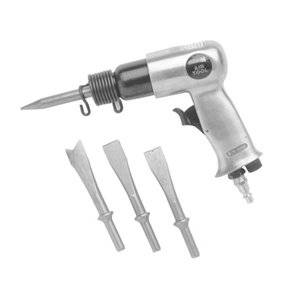

The dimple DOES serve a purpose to the tech fixing your car/equipment/etc. Many times, the splines will rust or seize in the hub/bearing assembly (depending on the application, I'm mostly speaking from an automotive standpoint). When the time comes to take it apart for a repair the tech doesn't want to mushroom out the end of the shaft with a hammer (it will be more stuck) so instead, the easiest way is with an air hammer that has a pointed bit attached.
Such as this:
Stick that in the dimple, and it will push out like butter.
