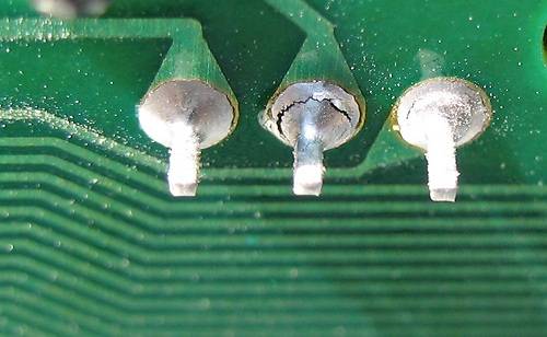

Well. Good start, but he should check these too:
It's not repair: it's just the basic check before repair.
