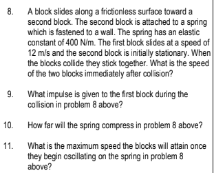

How to solve? I don't know how to do it as mass is not given and the distance of the spring is not given either. May be impossible to solve (teacher is not the most cautious)
P=mv
KE = 1/2mv^2
U=1/2kx^2
1/2mv^2 = 1/2mv^2 - 1/2kx^2 but can't plug in numbers for x or m
mv+mv=mv+mv but no mass given
very lost

Without more information (like the two masses) you can't solve anything. Do earlier problems introduce something? Is there a sketch that might have information?
You could express all answers as function of m1 and m2, of course.

Unfortunately, my teacher didn't provide any other information besides the question found in the picture. There's no image or sketch that my teacher provided, nor do they connect to previous questions. I'm guessing that this is simply impossible to solve (other than answering as functions of m1 and etc)
Being in your situation, rather than giving numerical responses, I would solve each question as function of ##m_1## and ##m_2##.
