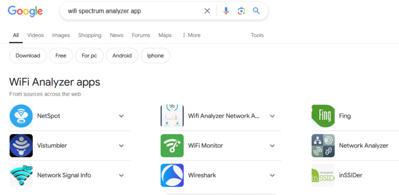

There are "spectrum analyzer" apps that you can get for your phone that will show you signal strengths, so you could download one of those and have a passenger watch the display as you drive around...
