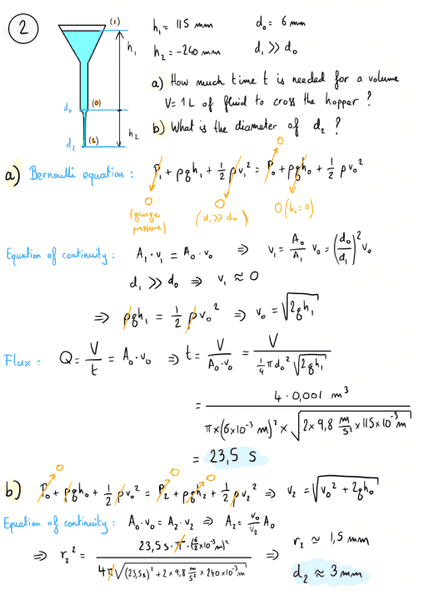

Hi everybody! I'm training for an upcoming exam, and I'd like to know if I correctly use the Bernoulli equation.
The problem is kind of difficult to describe without a drawing, please check out the attached jpg to see the situation and the known data.
The questions are:
a) How much time t is needed for a volume V = 1L of fluid to cross the hopper?
b) What is the diameter of d2?
Bernoulli equation, equation of continuity, formulas to calculate the flux of a fluid
a) I use the Bernoulli equation at points (1) and (0):
P1 + ρgh1 + ½ρv12 = P0 + ρgh0 + ½ρv02
Now I think that P1 = 0 (if we take the gauge pressure), ½ρv12 ≈ 0 (because the diameter at point (1) is much larger than at point (0) (equation of continuity)) and ρgh0 = 0 (because I choose h0 = 0).
What I am not sure of is that I assume P0 = 0 because the fluid is not being stopped at that point, so it should have no pressure. Is that correct? If so, here is where that takes me:
ρgh1 = ½ρv02
⇔ v0 = √(2gh1)
We can then use the flux to determine the time it takes for a litre of fluid to cross the hopper:
R = V/t = A0 ⋅ v0
⇒ t = V/(¼ ⋅ π ⋅ d02 ⋅ √(2⋅g⋅h1)) = 23.5 s
b) I use the Bernoulli equation again at points (0) and (2).
P0 + ρgh0 + ½ρv02 = P2 + ρgh2 + ½ρv22
I assume P0 = 0 and P2 = 0 for the same reason as before (is that right?) and ρgh2 = 0 (because I now choose h2 = 0)
⇒ v2 = √(v02 + 2⋅g⋅h0)
The equation of continuity says A0 ⋅ v0 = A1 ⋅ v1
⇒ A2 = A0 ⋅ v0/v2
⇒ r = 1.5 mm
⇒ d2 = 3 mmMy results are plausible, but I am unsure about how to deal with the pressure when there is a flow. Is there no pressure on the right side of the equation when there is a flow? Is that always the case?Thank you very much in advance for your answers.

Consider the linear velocity of the water in the two sections of pipe. Are they the same? If not, which is greater, and what can account for the acceleration?
@haruspex Well the equation of continuity (A1⋅v1 = A0⋅v0) states that the water flows faster by the smallest opening (point (0)). And I guess that that is happening because of a greater pressure at that point? Now the formulas I know for pressure are P = F/A or for an submerged object P = ρgh (probably irrelevant here). Is there another one I don't know, or am I missing something important? I can't say much about the force applying on the fluid at that point.
Exactly. So, as I suggested in post #5, apply the Bernoulli equation to the flow in the narrow section.
As I see it, the pressure at point 2 is atmospheric and the pressure at the very top of the hopper is atmospheric. So, from Bernoulli, $$v_2=\sqrt{2g(h_1+h_2)}=\sqrt{2g(0.115+0.026)}=1.66m/s$$
This means that the pressure immediately below point 0 (just below the convergence) is sub-atmospheric. The gauge pressure there would just be ##-\rho g h_2=-\rho g(0.026)##. It seems that there would be a jump change in pressure from just above point 0 to just below point 0, with the pressure above being higher than the pressure below. But, the question is, "how much higher?" It seems to me there is not enough information provided to solve this problem without knowing d2.

Here is a more fleshed out analysis of my discussion in post #15.
Let z = h1= elevation of top surface of liquid in hopper
Let z = 0+ = elevation of top of short diameter convergence
Let z = 0- = elevation of bottom of short diameter convergence
Let z = - h2 = exit elevation
Bernoulli term at each location:
##z = h_1##: $$0 + \rho g h_1 + 0$$
##z=0^+##:$$p^++0+\frac{1}{2}\rho v_0^2$$
##z=0^-##:$$p^-+0+\frac{1}{2}\rho v_2^2$$
##z=-h_2##:$$0-\rho g h_2+\frac{1}{2}\rho v_2^2$$
All the above Bernoulli terms must be equal to one another.
In addition, the velocities in the two tubular sections must satisfy:
$$v_0d_0^2=v_2d_2^2$$
These equations cannot be solved unless we know d2.

The question asks to find d2, but clearly there is insufficient information because one could just make d2 smaller and no given information would be contradicted. So my guess is that there is, or was intended to be, some other piece of information provided.
I think the person who formulated the problem just messed up and was confused, and then transmitted this incorrect analysis to the class.
