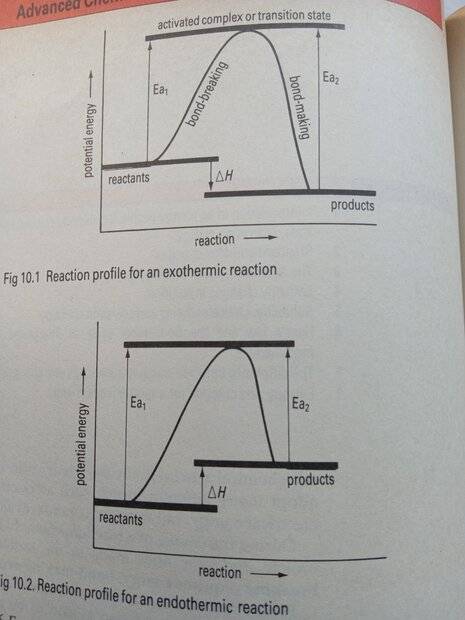

These diagrams illustrate what @Borek said: That is the total net effect , bond breaking/bond formation determines if reaction is endo or exothermic. And see the Krebs cycle regarding ATP. IE. The formation of ATP is endothermic. But ATP to ADP is an exothermic reaction because the products are in lower energy state.
