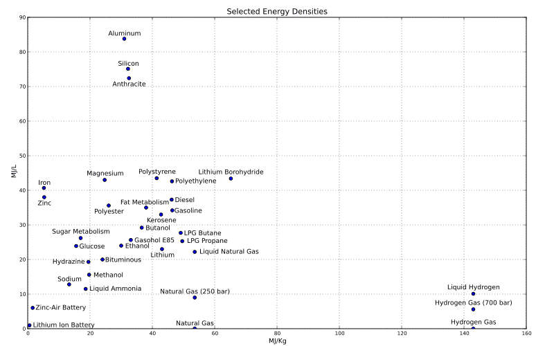

What possible advantage is there in using hydrogen as an energy storage product, when it is derived from hydrocarbons? About none, I'd think. Even in the global-warming-carbon-footprint camps it shouldn't make too much sense.
There is some. Electrochemical engines are about twice as efficient as comparable thermomechanical engines and as a result can produce less CO2.
Fuel cells by their very nature offer features that batteries can not. The obvious one is no need for recharging, longer life span, and much less to none of an environmental impact when being disposed of. Other advantages are greater power to weight ratios and no self discharging.

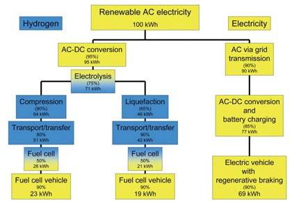

Hydrogen over fuel cells is the most efficient configuration for automotive applications if we have a source of hydrogen.
Translation: if we ignore it's inefficiencies, hydrogen is efficient! That's just an absurd thing to say, Ivan. The reality of the issue is that hydrogen is not an efficient energy storage medium because producing it is a very inefficient process. Something like half the efficiency of batteries when used in a fuel cell.
But from where I sit, fuel cells are far too expensive to be practical for [standard] personal vehicles any time soon. I tend to favor hydrogen for internal combustion. While this is far less efficient than hydrogen/fuel cell/ electric, traditional internal combustion engines can easily be modified to burn hydrogen without any significant loss of performance.
That's a terrible idea. Starting with an energy storage medium that's half as efficient as batteries and ending with a usage that cuts the efficiency by an additional factor of 3. Now you have a car that operates at 1/6 the efficiency of a battery operated electric car. That's a big step backwards.

Something like half the efficiency of batteries when used in a fuel cell. That's a terrible idea. Starting with an energy storage medium that's half as efficient as batteries and ending with a usage that cuts the efficiency by an additional factor of 3. Now you have a car that operates at 1/6 the efficiency of a battery operated electric car. That's a big step backwards.
If we consider lifetime efficiency of the car [and all required technology], it may make sense if we have a good source of hydrogen. What's more, electric is not always an option, such as for trucks. Also, the grid could not sustain a nation of electric vehicles and may not be able to for many decades to come.
