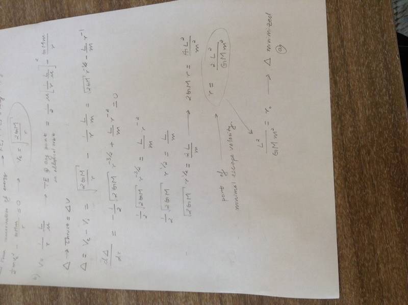

If I trying to find the optimal point for escape in an elliptical orbit, can I just differentiate the standard escape velocity eqn with respect to r? I know it must be either the apogee or the perigee...is there a better approach?
Escape velocity is a speed, not a velocity. The easiest way to attain that velocity is for a vehicle to thrust in the direction it is already going. The minimum delta V needed to escape at some point is the difference between the current velocity at that point and the escape velocity at that point. It is this value you want to minimize, not the escape velocity.
So I tried doing precisely that, I minimized a 'thrust' but the expression I arrive at doesn't look like the perigee...
Handwritten derivation, rotated sideways, of an effective potential V and a thrust expression set equal to a change in potential, minimized with respect to r, giving r = 2L^2/(GMm^2).

So I tried doing precisely that, I minimized a 'thrust' but the expression I arrive at doesn't look like the perigee...View attachment 68288
You used the wrong expression for orbital velocity.
A good place to start is the vis-viva equation. Unfortunately, you'll get no joy here if you differentiate the resulting delta V with respect to r. The problem is there's nothing that constrains r in either the vis-viva equation or the escape velocity equation.
You'll need something such as the orbital equation of motion, ##r=\frac{a (1-e^2)}{1-e\cos\theta}##. Now you should get something useful. In particular, you should find that extrema occur at apofocus and perifocus. So now it's just a matter of determining which is best, which is worst.
