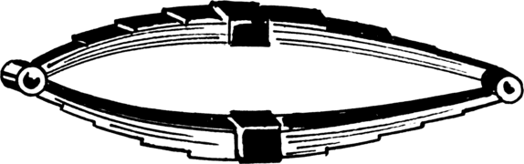

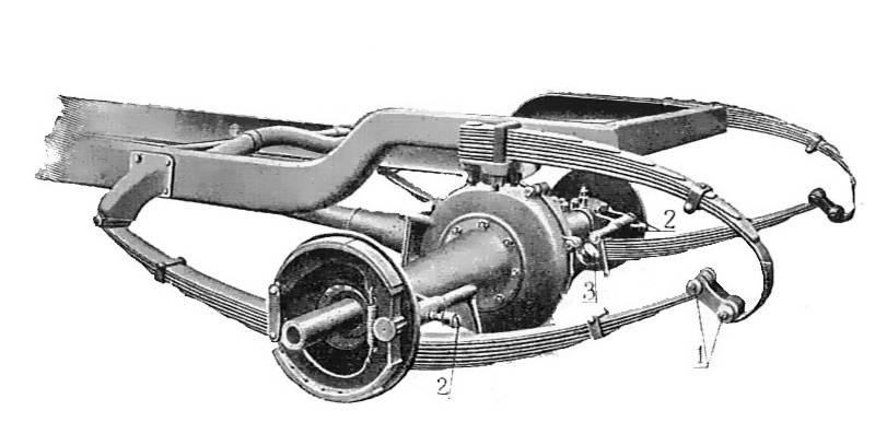

leaf spring
  • Line drawing of a multi-leaf spring, a stack of curved steel plates clamped together at the centre with a block and eyelets at each end.
  • Black and white illustration of a vehicle rear axle assembly with semi-elliptical leaf springs, brake drum and differential housing, with numbered callouts 1, 2 and 3 pointing to parts.
