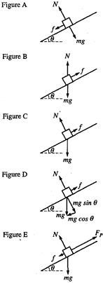

For 4, 5 & 6
Five free-body diagrams labelled Figure A to Figure E, each showing a box on an incline at angle θ with arrows for normal force N, friction f, weight mg, and applied force Fp in Figure E; Figure D also resolves mg into mg sin θ and mg cos θ.
4. Which figure best represents the free-body diagram for the box if it is accelerating up the ramp?
(A) Figure A
(B) Figure B
(C) Figure C
(D) Figure D
(E) Figure E
my answer: E
5. Which figure best represents the free-body diagram for the box if it is at rest on the ramp?
(A) Figure A
(B) Figure B
(C) Figure C
(D) Figure D
(E) Figure E
my answer: C
6. Which figure best represents the free-body diagram for the box if it is sliding down the ramp at constant speed?
(A) Figure A
(B) Figure B
(C) Figure C
(D) Figure D
(E) Figure E
my answer: C
