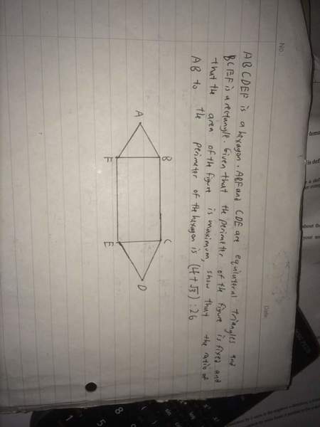

this is the given problem:
Handwritten geometry problem: ABCDEF is a hexagon. ABF and CDE are equilateral triangles and BCEF is a rectangle. Given that the perimeter of the figure is fixed and the area is maximum, show that the ratio of AB to the perimeter of the hexagon is (4+√3):26. Below it, a diagram of the hexagon with vertices A, B, C, D, E, F.
