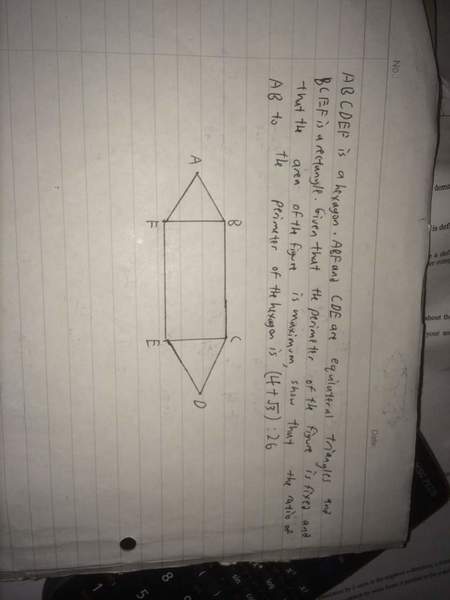

this is the given problem:

Do not post thumbnails. Please read the 'pinned' thread 'Guidelines for students and helpers', which explains the reasons for this policy.
You're told that the perimeter is fixed, which means that P is some constant. You can represent y in terms of P and x so that you then have the area A in terms of just one variable x.
