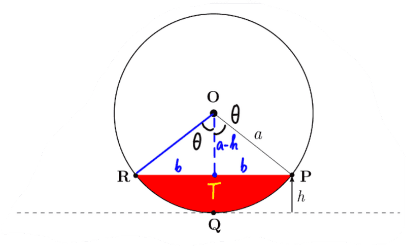

Drawing : I put the image of the problem to the right. O is the center of the circle distant ##a## from the circumference like points P and R. At a height ##h## from the base Q, a segment is cut and shaded in red. I have to calculate the area of the shaded region RPQR.
Attempt : I do the problem in two ways, one using the methods of algebra and trigonometry and the next using calculus. The trouble is, my answers don't match.
Circle with centre O and radius a, with a horizontal chord RP at height h above the lowest point Q; the segment below the chord is shaded red, with point T on the chord and labels b, a-h and theta marked.
##{\color{blue}{\mathbf{I. Algebra}} :}## From the diagram alongside, ##\cos\theta = \frac{a-h}{a}=1-\frac{h}{a}##. Area of sector ORQPO : ##\mathcal{A}_{\text{sector}}(\text{ORQPO}) = \dfrac{1}{2}a^2(2\theta) = a^2\theta=a^2\cos^{-1}\left(1-\frac{h}{a}\right)\qquad{\color{blue}{\mathbf{(1)}}}##
The base of ##\triangle OPT = b = \sqrt{a^2-(a-h)^2}=\sqrt{2ah-h^2}##.
Area of triangle ORPO : ##\mathcal{A}_{\triangle} (\text{ORPO}) = \frac{1}{2}\times 2b\times (a-h)=b(a-h)=(a-h)\sqrt{2ah-h^2}\qquad{\color{blue}{\mathbf{(2)}}}##
Using (1) and (2), area of the segment RTPQR : ##\boxed{\mathcal{A}_{\text{segment}}(\text{RTPQR})} = \mathcal{A}_{\text{sector}} - \mathcal{A}_{\triangle} = \boxed{a^2\cos^{-1}\left(1-\frac{h}{a}\right) - (a-h)\sqrt{2ah-h^2}}\qquad{\color{blue}{\mathbf{(3)}}}##

The expressions in (3) and (6) would be the same if ##\quad\underline{\cos^{-1}\left(1-\dfrac{h}{a}\right) = \sin^{-1}\left(\dfrac{h}{a}\sqrt{\dfrac{2a}{h}-1}\right)}##.
The only thing I know from inverse trigonometric functions is that ##\sin^{-1}x+\cos^{-1}x=\dfrac{\pi}{2}##. Clearly, this doesn't reduce from expression to the other in the underlined equation above.
Request : A hint regarding the underlined equation above involving the inverse cosine and sine expressions.

All the same, I have done the problem, that is, I have shown that ##\quad\underline{\cos^{-1}\left(1-\dfrac{h}{a}\right) = \sin^{-1}\left(\dfrac{h}{a}\sqrt{\dfrac{2a}{h}-1}\right)}##.
I did this by taking a right angled triangle and using the Pythagorean theorem, whereby the angle ##\theta=\cos^{-1}\left(1-\dfrac{h}{a}\right)## turns out the same as the angle given by ##\sin^{-1}\left(\dfrac{h}{a}\sqrt{\dfrac{2a}{h}-1}\right)##.
Silly from my side, again. Sorry to waste your time, forget about mine.
