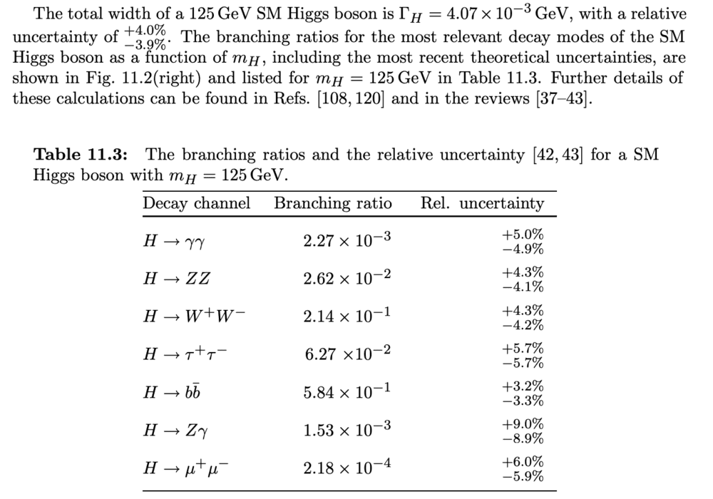

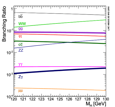

UPDATE: I was overly generous, as seen in the reference at the bottom of this post. I've left the analysis that made an overly generous estimate seem to make sense because more data points are always good. But skip to the bottom for the ultimate answer. END UPDATE PART ONE.
Most of the calculation of the branching fractions of a Higgs boson decay are QED and weak force calculations which are quite precise at a pretty small number of loops, unlike QCD calculations of SM expectations which are vastly more imprecise. I'm pretty sure that I've seen the predicted branching fractions calculated to at least three significant digits and those were probably truncations of the full result. The decays of a 125 GeV Higgs boson in the Standard Model are approximately as follows (with observed decays that are experimental hints of observations for as noted in previous posts on this thread, in bold):
b-quark pairs, 58%

UPDATE PART TWO all that analysis aside a PDG review as of 2018, below, cites the uncertainties in the Standard Model expectation as higher than I would have expected, because in each of the three significant digit quoted branching ratios the relative uncertainty makes anything more than two significant digit values spurious accuracy.
These uncertainties are significantly smaller than the uncertainty in the experimental measurement uncertainties of signal strength, but hardly negligible either.
Figure 11.2 (right):
From the same source "the extremely small branching fraction to e +e −," is "approximately 40,000 times smaller than the branching fraction to dimuons."
From the same source, some of the experimental uncertainties as of 2018 (they are bit better now) were as follows (references omitted):
