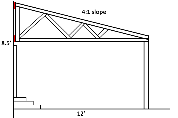

Do I need two nailing boards to attach this trussed roof to my house?
I'm planning to tear down the old metal gazebo over the patio and build build a porch roof over the side door. It's a sliding door that is raised 18" above the patio, so its total height is about 8½ feet.
I figure a nice trussed structure will be sturdy enough, especially since it sticks out 12 feet. I believe our local codes require at least a 4:1 slope.
I've never attached a structure to a house before; I've always avoided that by building free-standing structures. So I'm not 100% sure how to attach it.
I need a nailing board which is bolted and glued to the brick face of my house. That'll serve to attach the roof face. Is it common to attach a second nailing board just above the door? I mean it looks pretty obviously like I have to, I just haven't come across a lot pf plans showing this.
(TBH, it wasn't my intention to have the porch ceiling 8½ feet up, but the height of the door means it has to be, unless I make some weird design change.
Trusses should hang from the bottom horizontal member, never from the web or top member, as per manufacturer's instructions.
Then, they should be strapped to the supporting ledge (for wind load uplift), which should be bolted to the brick wall (preferably with all-way-through bolts and nuts).

OK, this is concerning, because what you're saying makes no sense to me.
How can trusses hang from the bottom member? I can't even picture that.

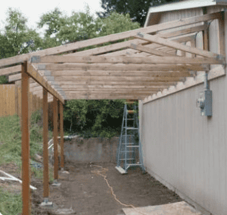

This is similar to what I'm planning to build:
I don't know what parts of this might or might not apply.
What keeps that from racking in the front-back axis (my front-back as I look from the vantage point of that picture)? It seems like some sturdier support posts and some triangle bracing near the top of those posts would help a lot to resist racking in that axis...
Oh, I'm gonna put some cross-bracing in.
It's just the attachment to the wall I'm concerned about, really. The picture I included is just something I grabbed to show lnewqban what my intended design is, truss-wise.

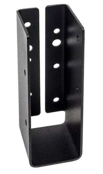

The attachment of the trusses to the wall must tie the trusses directly into the wall studs. If the trusses align with the studs, you MIGHT be able to use concealed flange joist hangers. Otherwise, you will probably need to install ledgers lag bolted to the wall studs, then support the trusses with joist hangers. The trusses will need to be supported at both top and bottom so as to positively prevent them from flopping over. This is a detail that needs to be discussed with your building inspector.
Concealed flange joist hanger:
The JLC articles linked in Post #2 are all good reading. There is more than one way to support a deck. Your lean to roof has similar loads as a deck of similar size, so the solutions are similar. With the exception that you do not have a rim joist to fasten to.

Without a doubt. Thats the very thing Im highlighting in my opening post. A nailing board at top and bottom, which apparently is also called a ledger board.
I assume that the brick is a facade, with a load bearing wall behind the brick. If that is the case, then you would need to remove the brick behind the new trusses to attach directly to the load bearing wall underneath.
If you use ledger boards, remember that those boards support the entire roof, so they need to be attached with more than just a few nails.
I don't know if this is the way it's usually done. I see plenty of lean-to roofs attached without having to remove the brick.

I humbly stand corrected, and you vindicated.
My local construction contractor cum lumber expert said the regulations now require joining through the brick to the joists - even removing brick if necessary.
He did suggest that - were I to put 6x6 posts down against the wall - it would obviate the need for the ledgers to take the load.
So basically, I'm making a self-supporting structure that happens to stand close enough to (and steadied by) the wall of my house that flashing will keep it water proof.
And that I am much more comfortable with.

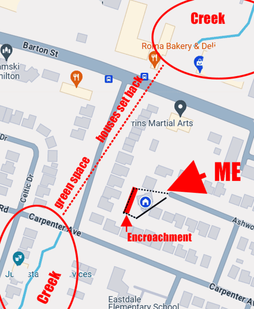

Indeed. There is an underground river that runs right behind my house. It affects how the next row of houses are built.
And (we discovered upon receiving the key) there is a 10 foot 'no-go' zone* along our back fence that parallels the river.
* I forget what it's called. A City Encroachment? It's an area where we are not allowed to build on because there are underground structures - probably a drainage culvert.

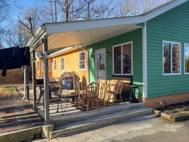

I built a porch roof similar to your specs. I was able to tie in the house side directly to the end of the existing roof. 2x6 roof joists were sufficient for my span. You might need 2x8's considering your span and snow load. I finished the underside of the joists with vinyl soffit material. A beam supported by 3 posts holds up the other end. Seems like trusses are additional work and cost. A ledger beam attached through the brick into framing members or better yet the 2nd floor rim joist if possible should be plenty strong, the brick supports the vertical load and the framing members of the house the pull out forces which should not be that great. We had to make a simple sketch of the design and submit to the local code department along with a small fee.
