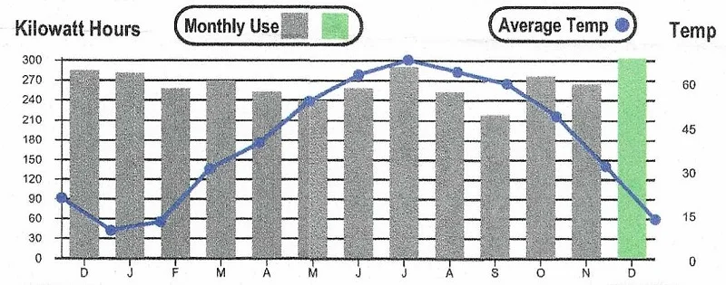

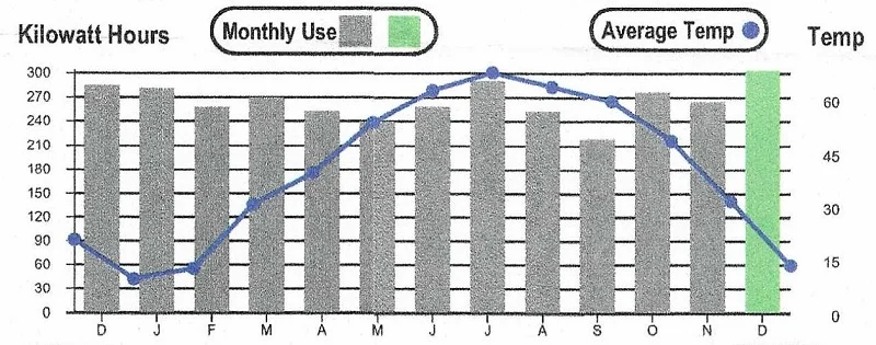

And your total power consumption per month would be?
And are your numbers over a full year, or a segment of a year?
From my electric bill for December 2025.
July was high because of air conditioner and dehumidifier. December and January are high because of furnace blowers. Electric dryer is used year around. Computers are turned off when not in use. All lights are LED.
The house was designed to be energy efficient. In 2022, we used 670 therms of natural gas for heating house, shop, and domestic hot water. That year had 9725 heating degree days (65 deg F basis).
