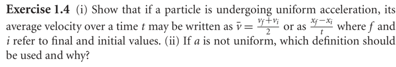

Show that if a particle is undergoing uniform acceleration, its average velocity over a time ##t## may be written as ##\bar{v} = \dfrac{v_f+v_i}{2}## or as ##\dfrac{x_f-x_i}{t}##, where ##f## and ##i## refer to initial and final values.
1. Average velocity is defined to be ##\quad\bar{v} \overset{\text{def.}}{=}\dfrac{\Delta x}{\Delta t}##.
2. For uniformly accelerated motion, final velocity ##\quad v_f=v_1+a_0(t_f-t_i)##
Printed textbook exercise 1.4 asking to show that average velocity under uniform acceleration equals (v_f + v_i)/2 or (x_f - x_i)/t, and which definition to use if acceleration is not uniform.
Statement of the problem :
Let me copy and paste the problem from the text. Please note it's part (i) that I am seeking to answer. I know the answer to part (ii).

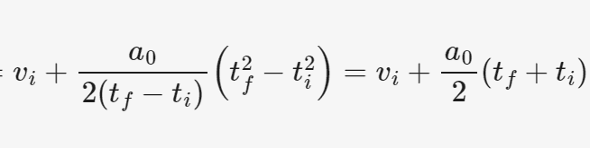

Solution : To show where my error appears, I take the time(s) to be ##t_f## and ##t_i##, whereby the given time interval ##t = t_f-t_i##. The average velocity ##\small{\quad\bar{v}\overset{\text{def.}}{=}\dfrac{\Delta x}{\Delta t}= \dfrac{\int\limits_{t_i}^{t_f}v(t)dt}{t_f-t_i}=\dfrac{\int\limits_{t_i}^{t_f}(v_i+a_0t)dt}{t_f-t_i}=v_i+\dfrac{a_0}{t_f-t_i}\left[ \dfrac{t^2}{2} \right]_{t_i}^{t_f}=v_i+\dfrac{a_0}{2(t_f-t_i)}\left( t_f^2 - t_i^2\right) = v_i+\dfrac{a_0}{2}\left( t_f+t_i \right)=\dfrac{v_i+\{v_i+a_0\left( t_f+t_i\right)\}}{2}}##
The last term is not equal to the final velocity ##v_f## : ##\quad\dfrac{v_i+\overbrace{\{v_i+a_0\left( t_f+t_i\right)\}}^{\ne v_f}}{2}\ne\dfrac{v_i+v_f}{2}##.
We note that the final velocity ##v_f=v_i+a_0(t_f-t_i)##. For me, the minus sign ##-## is replaced with a plus##+## sign.
This is where I am stuck. Request : A hint would be welcome.

Equation: = v_i + a_0 / (2(t_f - t_i)) (t_f^2 - t_i^2) = v_i + (a_0/2)(t_f + t_i)
From my calculations above. The two terms which have "##-##" signs cancel, leaving the term ##t_f+t_i##.

I don't follow you. What you wrote is exactly what I did.
##x_f -x_i = v_i(t_f-t_i) +\frac 1 2 a(t_f^2 -t_i^2)##
If you divide both sides of the equation by ##t_f-t_i##, you get ##\bar v= v_i+\dfrac{1}{2}a_0(t_f+t_i)##, which is what I got.

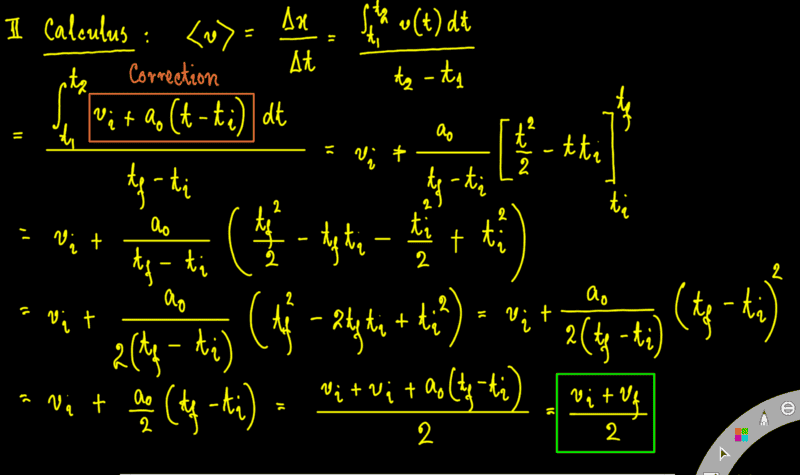

Your integration is fine. What you have inadvertently done is used the wrong function for ##v(t)##. I ask you to evaluate ##v(t)## at ##t=t_o## and tell us what you get.
I got you. We should have ##v(t) = v_i+a_0(t-t_i)##. Hence when ##t=t_i##, ##v(t_i)=v_i##.
I show you the calculations below in rough. Thanks. I have solved the problem.
Handwritten calculus derivation on a black background deriving average velocity <v> = (1/(t_f - t_i)) times the integral of v(t) dt, giving v_i + a_0(t_f - t_i)/2 and then (v_i + v_f)/2, with the final result boxed in green.
