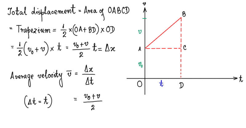

The displacement is the signed area under a velocity vs time graph. For constant acceleration the graph is composed of a rectangle (of height ##v_0## and length ##t##) and a triangle (of height ##v - v_0## and length ##t##). Calculate the area and divide by the time ##t##.
Thank you @PeroK. Yes I know of that method; my issue was a bit different. Nevertheless, let me do as you said first.
Attempt : I use Autodesk Sketchbook##^\circledR## for easy writing, hoping am not violating anything.
Issue : There are three ways to derive the well-known three formulas in galilean kinematics, viz. (1) ##v=v_0+a_0t##, (2) ##x=x_0+v_0t+1/2 a_0t^2##, and (3) ##v^2 = v_0^2+2a_0(x-x_0)##. Those three ways are (a) Algebraic ?, (b) Graphs ##\checkmark##, (c) Calculus ##\checkmark##. I put checkmarks against the last two because I can derive formulas (1)-(3) in those ways. I am stuck at method (a), algebraic. Only because I cannot show, algebraically, how is it that the average velocity ##\bar v = \frac{v_0+v}{2}##.
Note : Formula (1) follows simply enough from algebra, because the acceleration is uniform : ##a_0 = \frac{v-v_0}{t}\Rightarrow \boxed{v=v_0+a_0t}##.
If I could show how ##\bar v = \frac{v_0+v}{2}## (?), I could find the formula for net displacement (2) (see my post #1 where I have done it) and with some algebra, the final velocity in terms of initial velocity and net displacement (3).
Request : Please show me how is ##\bar v = \frac{v_0+v}{2}##, using methods of algebra. To be honest, I don't even know if it's possible. Or I can't see how.
$$\bar v = \frac d t = \frac{v_0t + \frac 1 2 at^2}{t} = v_0 + \frac 1 2 at= v_0 + \frac 1 2(v - v_0) = \frac {v_0 + v}{2}$$Give me a nomination for the Nobel Prize!

Smiles. I am afraid you are assuming that the displacement ##d = v_0t+\frac{1}{2}at^2##. How do you show that, algebraically? If you read my post #3 above, I arrive at the formula for displacement using the value for the average velocity. Which is the opposite of what you have shown.
The average velocity ##\bar v = \frac{v_0+v}{2}## is more native but difficult to show (for uniform acceleration).
Is there a way to show that the average velocity ##\bar v = \frac{v_0+v}{2}## using small increments in time from start to finish, ##\delta t##, over the whole interval? For example, the initial velocity is ##v_0## and the final ##v##. The velocity a second after time ##t=0## is ##v_0+a_0##. The velocity a second before the final velocity is ##v-a_0##. If the average velocity is ##\bar v = \frac{v_0+v}{2}##, then we can (easily) show it to be the case for both the first and last instants as well as any of the instances in between, with equal amounts added to and taken off the first and last instants.
Could this happen if the acceleration was non-uniform? Surely my method above, even if accepetable, cannot be considered a proof.
Constant acceleration means that velocity against time is a straight line. The average height of a straight line segment is the average of the heights at the two ends. That's fairly elementary.
You're claiming that's difficult to show?
I was claiming that it's difficult to show if you don't use graph-analogy and restrict yourself only to algebra. As @kuruman's post #9 above shows, you really cannot restrict yourself to algebra when you're speaking of continuously varying quantities. The use of calculus is inevitable.
But this is what I had in mind.
