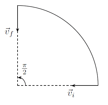

A particle of mass ##m## moves along a circle of radius ##R##. The modulus of the average vector of the force acting on the particle over the distance equal to a quarter of the circle is:
  1. zero if the particle moves with uniform speed ##v##.
  2. ##\dfrac{\sqrt2mv^2}{\pi R}## if the particle moves with the uniform speed ##v##.
  3. ##\dfrac{2\sqrt2mv^2}{\pi R}## if the particle moves with the uniform speed ##v##.
  4. ##ma##, if the particle moves with constant tangential acceleration '##a##', the initial velocity being equal to zero.
$$\vec{F}_{avg}=m\vec{a}_{avg}$$
$$\vec{a}_{avg}=\dfrac{\displaystyle\int{\dfrac{dv}{dt}}dt}{\displaystyle\int{dt}}=\dfrac{\displaystyle\int{dv}}{\displaystyle\int{dt}}=\dfrac{\displaystyle\int{a}dt}{\displaystyle\int{dt}}$$
$$\vec{a}_{avg}=\dfrac{\Delta v}{\Delta t}=\dfrac{v_f-v_i}{t_f-t_i}$$
Okay these are all the formulas that I know for the average acceleration (or that I have devised from the my knowledge), do write some more if you know.
Let's consider the first case where the particle executes uniform circular motion, in this case the average acceleration will be ##\vec{v}=\dfrac{\vec{v}_f-\vec{v}_i}{\Delta t}##
Consider the figure of the mentioned case given:-
As ##\vec{a}_{avg}=\dfrac{\Delta v}{\Delta t}=\dfrac{-v\hat{j}+v\hat{i}}{\Delta t}##
Now, as the particle moves with same speed, so the time taken to cover quarter circle will be ##\Delta t= \dfrac{\pi r}{2v}##
$$\therefore \vec{a}_{avg}=\dfrac{2v^2(\hat{i}-\hat{j})}{\pi r} \implies \left|\vec{a}_{avg}\right|=\dfrac{2\sqrt2v^2}{\pi r}$$
##\therefore \text{The average vector force acting on the particle over the distance equal to a quarter of the circle $\\$ if the particle executes uniform circular motion is} \implies |\vec{F}_{avg}|=\dfrac{2\sqrt2 mv^2}{\pi r}##

But then what about the first attempt that I made regarding this case, it (till now) seems perfectly fine to me, because it is also correct to define average acceleration as change in velocity over the time in which the change took place, in which case the first attempt seems fine to me.
First attempt is fine and matches answer 3. That's what I meant earlier when I said,

Not that one, I was referring to the first of the two attempts that I made regarding the accelerated circular motion of the particle.
You mean this one?
decentfellow said:
The first approach being that in which we consider ##\vec{a}_{avg}=\dfrac{\Delta v}{\Delta t}##
Again, you are equating a vector to a scalar.
@decentfellow , in getting to your first answer (option 3) you used the net change in the velocity (vector). Why are you not using that approach in assessing option 4?
The tricky part, perhaps, is finding the speed after a quarter turn, but it's not hard. You can think of the tangential movement as being one dimensional, with a known initial speed, constant acceleration, and known distance.
kuruman said:
You mean this one?
Yeah I meant that one. And you are indeed correct it should be ##\vec{a}_{avg}=\dfrac{\Delta \vec{v}}{\Delta t}##.
And as @haruspex pointed out, I should deal with them with the vector approach. Although, I dealt with them with that approach only, it was just that I did not show it very clearly here.
After completion of the quarter circle the direction of the velocity is in the -ve x-direction , and its magnitude can be found as follows:
As, the body has zero initial linear velocity(hence angular velocity also), so we have
##\dfrac{1}{2}\alpha t^2=\dfrac{\pi}{2} \implies t=\sqrt{\dfrac{\pi}{\alpha}}=\sqrt{\dfrac{\pi r}{a}}##
So, as the particle completes its quarter circle its linear velocity, is ##\implies \omega=\alpha t \implies \omega=\dfrac{a}{r}\sqrt{\dfrac{\pi r}{a}}=\sqrt{\dfrac{\pi a}{r}} \\
\therefore v=r\omega=\sqrt{\pi r a}##
So, we get ##\vec{v}=-\sqrt{\pi r a}\hat{i}##, therefore the average acceleration vector will be ##\vec{a}_{avg}=\dfrac{\Delta \vec{v}}{\Delta t}=-\dfrac{\sqrt{\pi r a}}{\sqrt{\dfrac{\pi r}{a}}}\hat{i}=-a\hat{i}##. So, we get the magnitude of average acceleration as ##|\vec{a}_{avg}|=a##, hence the magnitude of average vector of force is ##|\vec{F}_{avg}|=m|\vec{a}_{avg}|=ma##.
This method does give the magnitude of average vector of force to be ##ma##, but why does the method which included integration give such an other worldly answer (it certainly looked like that to me).
Also, I just noticed that I have made a blunder while indicating the velocity vectors in the diagram that I uploaded in the OP, so yeah just swap the direction of the vecotrs.
In that approach, you were integrating anet, taking that as the magnitude of the acceleration at time t. Integrating the magnitude of the acceleration will not give you the net acceleration (a vector). It's like confusing speed with velocity.
So you are saying that what I did wring in my second attempt was that that I was integrating a scalar and equating it to a vector. I think I found out what you were implying so, based on that I think the average acceleration should be ##\dfrac{\displaystyle\int{\left(-\dfrac{v^2}{r}\hat{r}+\vec{a}\right)}dt}{\displaystyle\int dt}##, am I right?
Yes, if ##\vec a## is defined as the tangential acceleration vector.
Yes I by ##\vec{a}## I meant tangential acceleration and the seems like the result is same as that which I got in the first attempt.
What I did was ##\vec{a}_{avg}=\dfrac{\displaystyle\int\left({-\left(\dfrac{a^2t^2}{r}\cos{\left(\dfrac{at^2}{2r}\right)}+a\sin{\left(\dfrac{at^2}{2r}\right)}\right)\hat{i}+\left(-\dfrac{a^2t^2}{r}\sin{\left(\dfrac{at^2}{2r}\right)}+a\cos{\left(\dfrac{at^2}{2r}\right)}\right)\hat{j}}\right)dt}{\displaystyle \int dt} \\
=a(\cos{\dfrac{at^2}{2r}}\hat{j}-\sin{\dfrac{at^2}{2r}}\hat{i})##
And the magnitude of average acceleration is ##a##.
Now I am pretty sure that the 4th option is definitely correct.
It is right. As you said previously,
##\vec{a}_{avg}=\dfrac{\vec \Delta v}{\Delta t}=\dfrac{\vec v_f - \vec v_i}{t_f-t_i}##
As ##\vec v_i=0##, ##\vec{a}_{avg}=\dfrac{\vec v_f}{t_f-t_i}##.
The magnitude of the average acceleration is the final speed divided by the time, and the speed is vf=a(tf-ti), as the tangential component of acceleration is constant.
