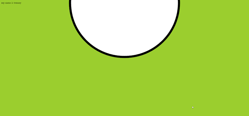

This is my background image.
I set:
background-position:50% 50%;
I get this as my output:
But I don’t understand the output.

shivajikobardan said:
I set:
Are you sure? That looks to me like background-position: 50% 0%;
background-position: 50% 50%;
isn't producing expected results like you said.
Perhaps the body doesn't have any height. Try adding height: 100vh;.
now, I'm getting different output when I try the same code with the image posted here.
And why is that unexpected after changing the code?
wow. this fixed. I didn't get the reason why this fixed? Body doesn't have height without us specifying?
Like any block element, the <body> will only have (inner) height if it has content, or if it is set as an attribute or in CSS.
