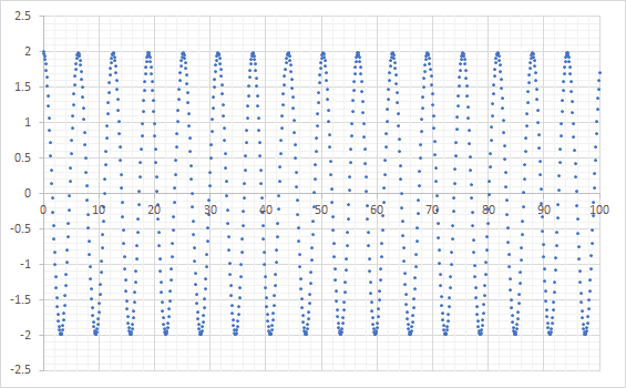

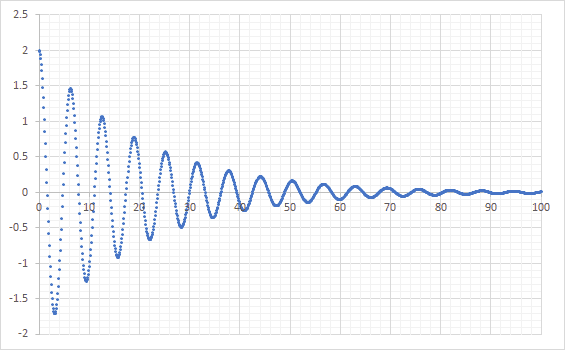

So I've been programming the BDF methods and for some reason I have an issue with the Backward Euler technique.
Given the differential equation y" + y = 0 (with y(0) = 2, y'(0) = 0), my backward Euler solution goes like this:
Obviously this is not possible as the function should be a well-behaved periodic. So I tried running my BDF2 and BDF4 on it, and this happens:
So yeah. What the actual flying :headbang::headbang::headbang::headbang:. I have had this issue since about a week and a half now and I am running out of ideas. I made sure that my backward Euler code isn't the problem as I used test functions from different literature like those in Chapra and such other examples available; and the results from my code and those in examples are practically identical to the last digit in those examples.
What's stranger is the fact that I used the same Backward Euler code in order to generate the initial points for BDF2/BDF4! I am totally confused and appalled.
Is there something with the backward Euler and periodic functions that I am missing?
In this case, the backwards Euler method with timestep [itex]h[/itex] yields [tex] \begin{pmatrix} 1 & -h \\ h & 1 \end{pmatrix}\begin{pmatrix} u_{n+1} \\ v_{n+1} \end{pmatrix} =<br /> \begin{pmatrix} u_n \\ v_n \end{pmatrix}[/tex] where [itex]u_n = y_n[/itex] and [itex]v_n = y_n'[/itex]. The eigenvalues of the matrix on the left are [itex]1 \pm ih[/itex], so their reciprocals both have magnitude [itex](1 + h^2)^{-1/2} < 1[/itex] for any positive [itex]h[/itex]. Thus [itex]|u_n| \to 0[/itex].
An alternative approach is to integrate once to obtain [tex] y' = \pm \sqrt{y(0)^2 + y'(0)^2 - y^2}[/tex] and solve that instead (remembering that you have to change signs whenever [itex]y' = 0[/itex]).
Finally: solving the recurrence relation yields [tex] \begin{pmatrix} u_n \\ v_n \end{pmatrix} = (1 + h^2)^{-n/2} \begin{pmatrix} \cos n\alpha & -\sin n \alpha \\<br /> \sin n \alpha & \cos n\alpha \end{pmatrix} \begin{pmatrix} u_0 \\ v_0 \end{pmatrix}[/tex] where [tex] \cos \alpha = \frac{1}{\sqrt{1 + h^2}}.[/tex] For [itex](u_0, v_0) = (1,0)[/itex] this yields [tex] u_n = \frac{\cos n\alpha}{(1 + h^2)^{n/2}}[/tex] as compared with the exact [itex]\cos nh[/itex]. You can see that the amplitude decays and the phase shifts.
Yes: first order methods perform badly on periodic functions. In general, explicit methods explode to infinity and implicit methods decay to zero (you can see this from the sign of the truncated ## f'' ## error term), and @pasmith has provided an execellent analysis for this particular problem.
Where are you learning about these methods from? If you are to use them successfully you can't skip the 'analysis' part of 'numerical analysis'.
