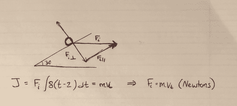

Indeed, I do not understand what you wrote under 2b above. What is Fi there? Why would there be an impulse parallel to the surface?
I think I am missing something here. I'm using Fi to represent the total horizontal impulse force (is it right to call it that?), which I then break into two components, one parallel to the surface, and one perpendicular.
So is the perpendicular force here the impulse force (equal and opposite forces on ball and cart), and the parallel component is not important? Is impulse force always perpendicular to the surface?
In the absence stickiness or friction, yes.
