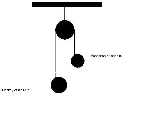

The monkey wishes to get the bananas. It starts climbing up with an acceleration 'a'.
Consider the situation using Newton's Laws of motion:
FBD for monkey:
T-mg=ma
For bananas:
T-mg=ma'
Its but obvious that a'=a. That is both the monkey and the bananas go up by the same acceleration.
Now consider this situation:
The monkey pulley and bananas are in one system. The external forces acting on the system is just the gravitaional force by the Earth which is 2mg(other components assumed to be massless) vertically downwards. And the tension in the string segment btween the rigid support and the pulley.
How will we explain the movement of centre of mass?

If I'm guessing your picture correctly, then the support, pulley and the Earth are in the same system as the monkey and bananas. The center of mass of the entire system doesn't move.

No: The pulley, monkey string and bananas are assumed one system by me.

I support Tim, its exactly what I presume, everything except the earth.

The pulley and support are free falling? Or is something holding them up?

They are not free falling.

If you read my first post carefully: I have mentioned tension in this segment of string as the external force.
You're right. So, what's the problem? If the monkey is to actually climb the rope, he must exert a tension greater than his weight. So there's a net upward force on the system.

A system with an 'external force' operating on it is not isolated. It's center of mass can move. Why should that be a problem? Can you state exactly what principle you are questioning?
I just wanted to get that Tension out without using Newton's Laws. Is it possible? Th centre of mass will have an acceleration 'a' upwards. Right? But you know this only if you have the value of tension in the upper string.

Consider the forces on the string that goes round the pulley …
The mass of the monkey equals the mass of the bananas in this case … so why should the centre of mass move? :confused: :wink: :smile:

You know that the tension in the upper string equals the sum of the tensions in the lower string. That explains where the external force comes form. But you already knew the acceleration of the masses from the tension in the lower string.
What's your beef with Newton?
