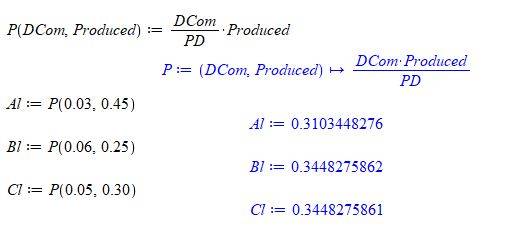

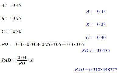

1) Suppose we pick up a defective apparatus. What is the probability it came from company A?
Here I use Bayes formula:
Defining the production in fractions.
Calculating the conditional probability (PD) and finding the probability it came from company A (PAD) to be 31%
2) If a defective apparatus is found, which company is most likely to have produced it?
Here I just calculate it for all three and find it is most likely company B and C

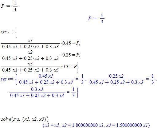

The way I tried to solve it, was to setup 3 Bayes equations with 3 unknowns, namely the new defective rates.
They are all equal to the same, as they are asked to have the same probability -> P = 1/3
I end up with this, where x1, x2 and x3 represents the respective companies (A, B and C).
However this assumes that the defective rate of company A (x1) remains constant, and it says in the problem description it can only increase.
Am I even on the right track? I feel like I have to differentiate, but I'm now sure what.

I might misunderstand you, but it says the defective rates can only increase, so how can we keep B and C constant?
You are only allowed to increase them means you cannot make them smaller. I don't think there's a requirement that you have to increase them all, or else the solution will just be to increase them by the smallest epsilon amount possible since you are trying to minimize your total defective rate.
Likes PeroK
Alright, that was my conclusion as well. If they were all different, one would have to remain the same. So is my result in the last image correct? It does ensure that they are all equal to 1/3.

I express the defection rates of B and C in terms of A's defection rate (x1).
From your explanations I think it's correct, as 2) gives the same answer when I plug it in.

You just want: $$45D_A = 25D_B = 30D_C$$ Where, as above, you can keep ##D_B = 6## and ##D_C = 5##.
Likes CharlesDamle
Okay, I made it way too complicated in my head.
Thank you very much!
