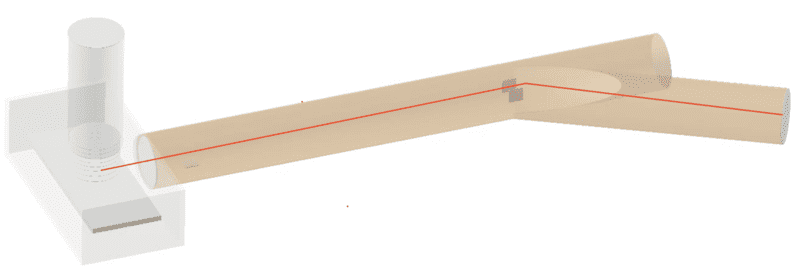

Hello! I have a setup consisting of some charged particles each of which is produced at a different position, ##(x_i,y_i,z_i)##. I don't know the exact position, but I know that each of the 3 variables is normally distributed with mean zero and standard deviation of 3 mm. What I measure in the experiment is the position of the particles on a 2D screen perpendicular to the trajectory of motion of the particles, call it x' and y' and the time from the moment they are produced to when they hit the 2D screen, call it t. So what i measure is ##(x',y',t)## with the associated uncertainties, given by the detector, ##(dx',dy',dt)##. What I want to do is, for each ion, from these measurements, to get the most probable starting point (together with the associated uncertainty). I am not sure what is the best way to proceed. What I want to get basically is:
$$p(x_i,y_i,z_i|x_f,y_f,t)$$
and I will write this just as ##p(x_i|x_f)## for simplicity. For example, assuming we had no uncertainty on our measurements, I could use Bayes theorem and have:
$$p(x_i|x_f) = \frac{p(x_f|x_i)p(x_i)}{p(x_f)}$$
I know ##p(x_i)## (which is Gaussian) and for a given event, ##p(x_f)## is constant (I don't know what it is, but it is constant). For ##p(x_f|x_i)## I can get a value by running some simulations. Assuming everything would be ideal, this would be 1 for just one value and 0 for everything else. Given that we can't model the electrodes perfectly, and I will run the simulation several times with slightly different potentials, this will probably have a distribution, too (say Gaussian for simplicity). From here I can get ##p(x_i|x_f)## and the associated standard deviation, which is exactly what I need.
However, given that I have noise on ##(x_f,y_f,t)##, I can't just apply the Bayes theorem directly as above. How can I account for these errors? Thank you!
EDIT: I attached before a diagram of the trajectory of the particle (red line) from the source to the 2D detector.

Hello! The initial position is distributed 3-D normally about the point (0,0,0). The final position is the one I measure.

1) The motion is not in the z direction. As I mentioned the x' and y' of the detector are in a different plane compared to the starting point (I will add a simulation picture in the original post)
2) Yes
3) The uncertainty on the energy is also gaussian, but for simplicity we can assume that the energy is constant for all particles.

Hello! So I actually don't have an ion trap. I have some atoms traveling and I ionize them (perpendicularly) at some point, ##(x_i,y_i,z_i)##. This initial positions are basically given by the distribution of the ion beam cross section and the laser beam (which is Gaussian with diameter of 3mm). At this ionization point, I collect the electrons (for now one can assume I do this one atom at a time), which give me ##t_i## and ##dt_i##. The ion travels to the MCP detector, and when it hits, I get the 2D position on the detector (together with the associated uncertainty) and the time ##t_f## with ##dt_f##. In practice the uncertainty in the ##t_i## is given by the direction in which the electrons are emitted, and from simulations it is about 2ns. For ##t_f## the uncertainty is the MCP resolution which is 100ps, so basically one can assume the uncertainty in the time traveled is a gaussian with a standard deviation of 2ns. The MCP position resolution is 100 micros. I also know the average energy of the atoms (10keV) and for the energy spread we can assume 10eV. So knowing the initial position to the accuracy mentioned above, the final position, the time it takes to travel (and the uncertainties, ignore the voltages for now) and also the distribution of the kinetic energies, what I really want to do is to extract the energy of each individual atom, which hopefully would be smaller than 10eV (this is a lot more detail than the original post, I tried to simplify it in the beginning).
