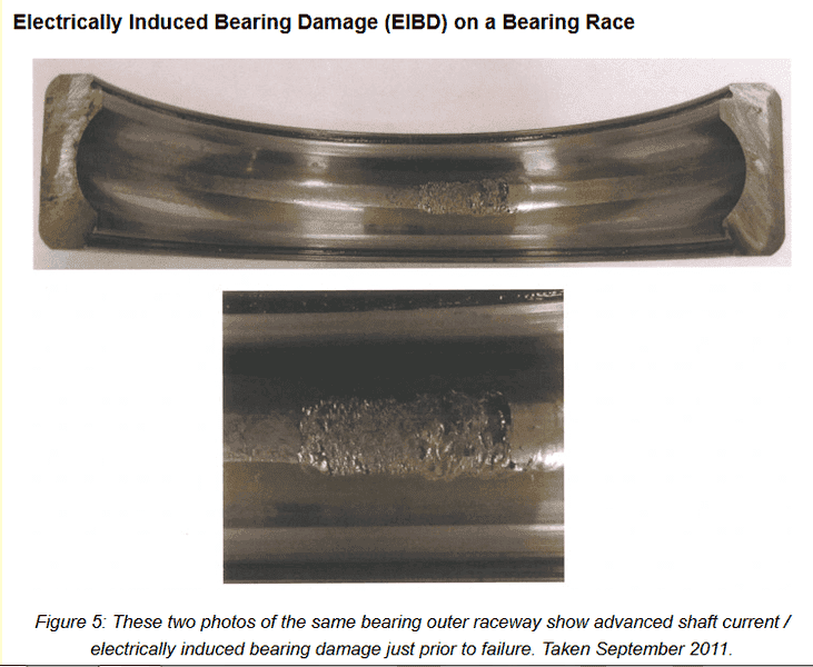

If an electrical machine that's larger than ~500 KW or used with VFD or SCR drives, study up on 'shaft currents' .http://www.vibescorp.ca/learn-about/shaft-currents/

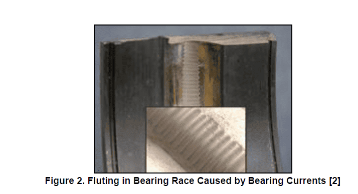

Any Rectifiers in it ? I'd be not a bit surprised if shaft current were the culprit.
We too failed twenty year bearings in ten months.
Harmonics aggravate the condition. It was a little known phenomenon until VFD's showed up in home appliances - suddenly washing machine manufacturers learned of it. There's much more published on it now than in 1970.
Sleeve bearings develop pits. Ball bearings develop regular marks and your immediate reaction is "What in the world made such a regular pattern on that race ? It's striped just like a raccoon's tail ! "
Of course as damage progresses it completely destroys the bearing race and the evidence, so maintenance tries different grease types while procurement blacklists bearing vendors one by one..
Fix is to insulate the bearing housing, as is done in big utility generators.

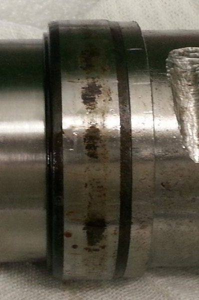

We had one that looked like your description. Let's see if this picture works...
This is of the inner race of a cylindrical roller bearing. The race of course is pressed onto the shaft in this photo. I was told by the bearing mfg. that this was due to the bearing sitting idle with water present. The bearing is oil lubricated and had sat for some number of months. We believe the oil had drained away and water condensed on the bearing. The areas where there are dark spots were areas between the cylindrical rollers where oil more easily drained away. Between the roller and race, the oil couldn't drain as easily so it didn't rust at that spot.
The bearing in the photo runs at very high speed, around 12,000 RPM. It made a very loud noise when operating, something like a siren. Later I discovered the outer race housing was not perfectly round. It was a few ten thousandths out of round, but I don't think that had anything to do with the racoon tail. It is worth inspecting parts however to verify the bearing mounting locations are perfectly round to eliminate one potential source of vibration.
Regarding vibration, another issue regards rotating parts being out of balance.
I don't believe that vibration alone however, would create any additional heating though I suppose that's possible.
That photo in post 6 looks a lot less regular than the raccoon tail stripes on my ball bearing, but it could be just farther along.
Do those spots continue all the way around the race?
www.eaton.com/ecm/idcplg?IdcService=GET_FILE&allowInterrupt=1&RevisionSelectionMethod=LatestReleased&Rendition=Primary&dDocName=AP040061E
Mine had stripes about 4x further apart than this bearing
IF yours is shaft current fluting, i'd suspect a magnetic effect at a low multiple of line frequency.
Honestly though, it looks to me a bit too irregular for that.
