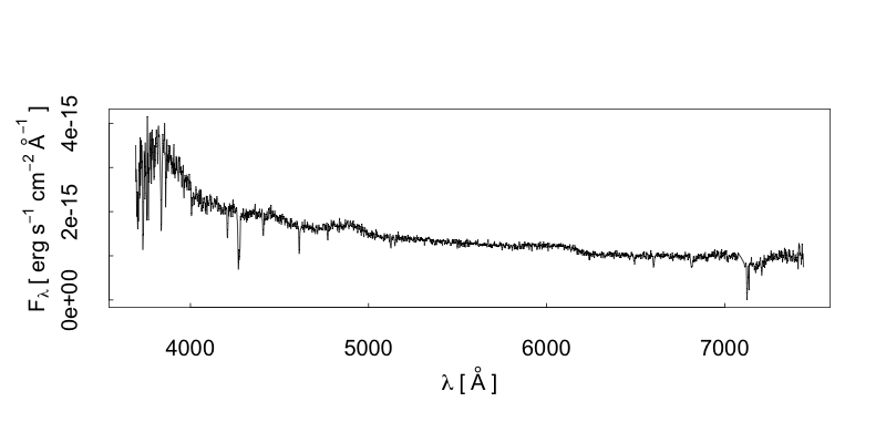

While I agree with @Ibix , if you really want the spectra, you can go to NED, enter TON618 and hit Go. Then if you click "Spectra", you can see the spectra, with references to where they came from. This may leave you with more questions than answers,
Reply

Hi phyzguy,
Thanks for giving me that lead to some very useful information. I shall follow that up with the hope that I may ask you for a pointer or two at some later date.
Many thanks for you help phyzguy. I've seen the spectrum data and have confirmed the value of z for myself thus satisfying my curiosity.
