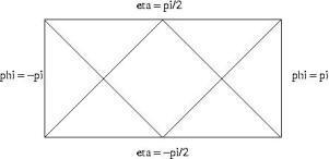

Looking just at the [itex]H^{1,1}[/itex] factor
[tex] ds^2 = \frac{-d\eta^2+dz^2}{\cos(\eta)^2/a^2}, \; \pi/2 < \eta < \pi/2, \; -\pi < z < \pi[/tex]
you can immediately draw the Carter-Penrose diagram (each point representing a sphere of radius 1/a in the Nariai dS-lambdavacuum) with lower and upper boundaries [itex]\eta=\pm \pi/2[/itex] and with sides [itex]z = \pm \pi[/itex] which we expect to identify. To confirm that this represents [itex]H^{1,1}[/itex], consider the embedding in [itex]E^{-1,2}[/itex] (signature -++):
[tex] X(\eta,z) = \left[ \begin{array}{c} <br /> a\, \tan(\eta) \\ a \, \sec(\eta) \, \cos(z) \\a \, \sec(\eta) \, \sin(z) <br /> \end{array} \right][/tex]
So the Penrose diagram makes this conformal to part of a cylinder with -+ signature. The upper boundary is future null infinity and the lower boundary is past null infinity. Notice this is a bit different from the diagram for de Sitter-lambdavacuum, which is discussed in Hawking and Ellis!

Last but not least, the Carter-Penrose diagram for the Nariai dS-lambda vacuum looks like this:
In this diagram, each point represents a two-sphere of radius a, and we should think of identifying [itex]\phi = \pm \pi[/itex], so that we have conformally mapped [itex]H^{1,1}[/itex] to a portion of a cylinder (with Minkowski signature). In the diagram, past null infinity corresponds to [itex]\eta=-\pi/2[/itex] while future null infinity corresponds to [itex]\eta=\pi/2[/itex].
This diagram is essentially the chart on [itex]H^{1,1}[/itex] with line element
[tex] ds^2 = \frac{a^2 \, \left(-d\eta^2 + d\phi^2 \right)}{\cos(\eta)^2},<br /> -\pi/2 < \eta < \pi/2, \; -\pi < \phi < \pi[/tex]
which can be obtained from the parameterization
[tex] X(\eta,\phi) = \left[ \begin{array}{c} <br /> a \, \tan(\eta) \\<br /> a \, \sec(\eta) \, \cos(\phi) \\<br /> a \, \sec(\eta) \, \sin(\phi)<br /> \end{array} \right][/tex]
In this diagram, note the two null geodesics which meet at [itex]\eta=-\pi/2, \, \phi=-\pi[/itex]. These are the two drawn above which as I remarked are parallel in [itex]E^{1,2}[/itex]. I stress again that they belong to different rulings in the double ruling! The figure showing theworld lines and orthogonal hyperslices of the eternally expanding observers has been oriented so as to suggest (I hope) its relation with the Carter-Penrose diagram.
Since embeddings are not physically significant, according to gtr, why do I give all these parameterizations? The reasons are mainly mathematical:
  • the corresponding embeddings provide a quick and easy check that we have not misinterpreted the global structure of our spacetime,
  • by identifying the components in two parameterizations (of the hyperboloid of one sheet, [itex]-x_1^2 + x_2^2 + x_3^2 = a^2[/itex], in [itex]E^{1,2}[/itex]), we easily obtain transformations between the corresponding two coordinate charts.
