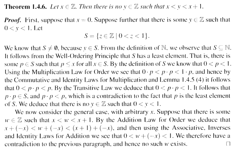

Theorem 1.4.6 and the start of the proof reads as follows:
Scanned page of a textbook: Theorem 1.4.6 stating no integer y lies strictly between x and x+1, followed by its proof by contradiction using the Well-Ordering Principle and the set S of integers between 0 and 1.
In the above proof ... near the start of the proof, we read the following:

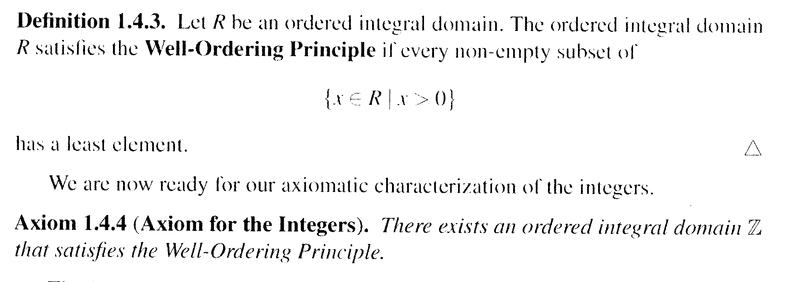

" ... ... From the definition of ##\mathbb{N}##, we observe that ##S \subseteq \mathbb{N}##. ... ..."Question: What exactly is the reasoning that allows us to conclude that ##S \subseteq \mathbb{N}## from the definition on ##\mathbb{N}## ... "The above theorem is in the section where Bloch defines the integers as an ordered integral domain that satisfies the Well Ordering Principle... ... as follows:
Screenshot of a textbook page: Definition 1.4.3 of the Well-Ordering Principle for an ordered integral domain R, with the set {x in R | x > 0}, and Axiom 1.4.4 stating that an ordered integral domain Z satisfies the Well-Ordering Principle.

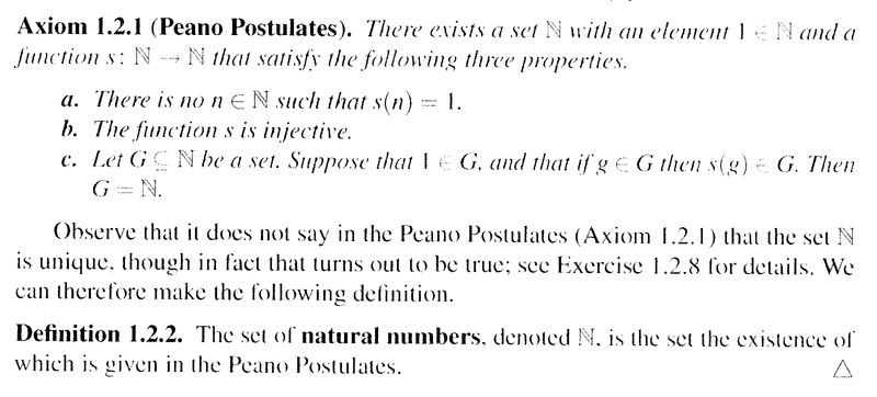

The definition of the natural numbers is mentioned above ... Bloch's definition is as follows ...
Scanned textbook page showing Axiom 1.2.1 (Peano Postulates) with parts a, b and c, followed by a paragraph and Definition 1.2.2 defining the natural numbers as the set given by the Peano Postulates.

Maybe I shouldn't answer my own questions ... but maybe I am worrying too much over a trivial point ... ... maybe the reasoning is simply ... as follows ...since ##S## is a set made up of positive integers then it is a subset of ##\mathbb{N}## ... is it as simple as that ..?
My apologies if it is that simple ...
Peter
Peter
As I read it, yes. However, I do not see immediately from the Peano axiom how the natural numbers are all positive, but this depends on the definition of the order as well. So somewhere between 1.2.1. and 1.4.6. the author should have shown (or defined), that natural numbers are positive.

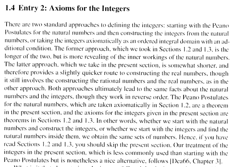

Bloch investigates two approaches to defining/constructing the integers as he describes here ...
Printed page with the heading 1.4 Entry 2: Axioms for the Integers, followed by a paragraph comparing two approaches to defining the integers: the Peano Postulates route and the ordered integral domain route.
In Section 1.4, where Theorem 1.4.6 occurs, Bloch is expounding the ordered integral domain approach to the integers ... so we should not go back to the Peano Postulates as I did - that is his approach number 1 ... under the second approach, the ordered integral domain approach, the Peano Postulates/Axioms become a theorem and are proved ...

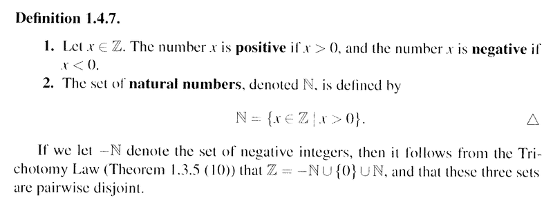

Actually when we meet ##\mathbb{N}## in the proof of Theorem 1.4.6 Bloch has not defined ##\mathbb{N}## yet in this approach ... he does so after presenting Theorem 1.4.6 as follows:
Text page showing Definition 1.4.7: x in Z is positive if x > 0 and negative if x < 0; N is the set {x in Z | x > 0}; then Z = -N union {0} union N, with the three sets pairwise disjoint.
Interestingly as Evgeny Makarov has pointed out in the Math Help Forum, the claim ##S \subseteq \mathbb{N}## seems unnecessary for the rest of the proof ...

Math Amateur said:
Interestingly as Evgeny Makarov has pointed out in the Math Help Forum, the claim S⊆NS⊆NS \subseteq \mathbb{N} seems unnecessary for the rest of the proof ...
It is not, because he needs ##p \in \mathbb{N}## provided by the well-ordering principle of ##S \subseteq \mathbb{N}.## Otherwise he wouldn't have the laws available, which he applies on ##p,## and which I assume were provided by the axioms (or derived statements) of the natural numbers.

Bloch is, in Section 1.4, dealing with the approach to defining/constructing the integers via defining the integers as an ordered integral domain that satisfies the Well-Ordering Principle ... not the approach through the natural numbers (see my previous post above). In the ordered integral domain approach the natural numbers the natural numbers are 'found'/defined as an embedded set within the integers. The relevant definition for the natural numbers is given in Definition 1.4.7 - unfortunately presented after Theorem 1.4.6. The definition reads as follows:
Text reading Definition 1.4.7: 1. Let x in Z. x is positive if x > 0 and negative if x < 0. 2. The natural numbers N are defined by N = {x in Z | x > 0}. Followed by a note that -N, the negative integers, gives Z = -N union {0} union N, with these three sets pairwise disjoint.

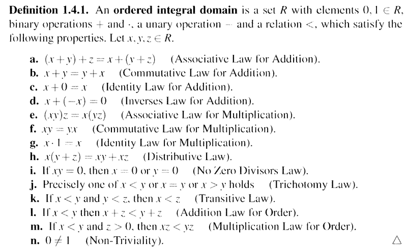

Once we have defined the integers as an ordered integral domain we have the following properties to call on in Theorem 1.4.6 ... and these properties include those named in the proof of the Theorem ...
Definition 1.4.1 listing the axioms of an ordered integral domain: addition and multiplication laws, identity and inverse laws, distributive law, no zero divisors, trichotomy, transitivity, order laws, and 0 ≠ 1.

One needs the well-ordering to get ##p \in S## (definition 1.4.3). Together with definition 1.4.7. this abbreviates to ##S \subseteq \mathbb{N}##. It is just another language as to say all elements of ##S## are positive. So whether you say all elements of ##S## are natural numbers or all elements of ##S## are positive, doesn't make a difference, it is the same. And which ever way you look at it, one of them is needed. So the language might be redundant, the fact is not.
