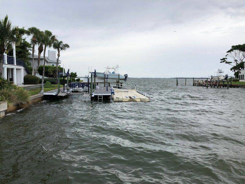

Building a 8' x 12' platform that will hold a small boat next to my dock. The platform needs to be able to be lowered below the surface of the water (launch boat) and lift above the water (store boat). Four pilings (one each corner) that each have an electric motor & reduction gearbox that has a spool to wind up & extend the wire cable (to raise and lower platform). Each motor/gearbox will need to handle 1000 lbs weight vertical lift (4000 pound total weight of platform and boat). The speed of the lifting/lowering process is insignificant (assume 3-5 feet plus/minus per minute). How do I choose the motor HP and the gearbox speed and torque capacity? The spool that winds the cable will be typical of what is found on a truck winch (3"-5" diameter?). I could add a pulley at the platform to double the wire cable. I need to use AC so either 110V or 220V motor. Thx!

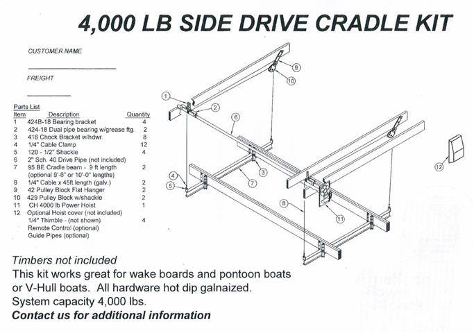

Having four motors is a really bad idea; nearly impossible to synch. Plus it will probably cost a fortune. Any of your designs should have only one motor.
Suggested designs:
Side drive cradle
Although the design does have transverse beams.

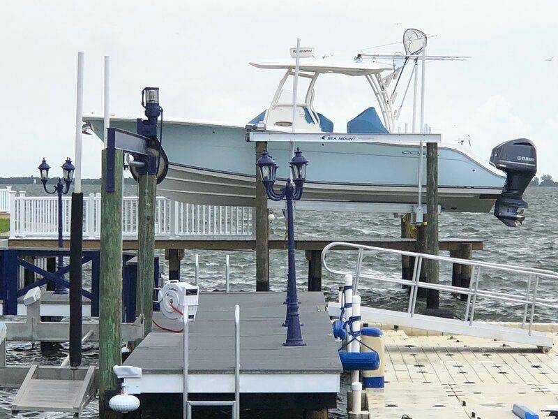

Cantilever lift
This one has no top transverse beams, but the larger ones seem to use hydraulics instead of cables. What I like about this design is that it has one cable, so if it breaks, the whole boat falls straight instead of having one end (or three corners) dangling in the air.

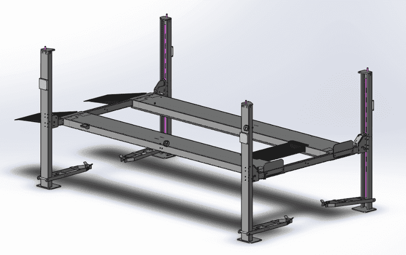

Four-post parking lift
This one is actually for cars but I think the design could apply to your need. No top transverse beams. The inside is as follow:
There is one hydraulic cylinder (I guess it could be a single cable connected to a winch) that is pulling 4 cables. The ends of each cable are connected to the top of each post. As the cables are pulled, the whole assembly raises. For safety, when the lift is at the correct height, it is locked by 4 pins (one in each post) instead of relying on the cables for support.
But I'm not sure if cables & pulleys resting underwater would be appropriate.

Gentlemen, all good input that I truly appreciate. I'm on west coast of Florida. ANYTHING that stays in the water for a week becomes part of the ecosystem. The solution is to position everything in air while not being used, NOT in the saltwater. Even the treated structural pilings are wrapped with a thick vinyl sleeve (from the sea bottom to above the high water line) to keep the worms from destroying the wood. No part of this lift can reside in the salt water and I do not want to duck under any beams (platform has to function as a deck) ... thus the choice to mount a motor/gearbox/pulley/wire cable on each piling. Yes it will cost more than a conventional lift that typically uses 2 motors and beams. So again, I'm asking for assistance from y'all on how to know how much torque I need out of a reduction gearbox to raise 1,000 pounds at 3-5 feet per minute using a spool that is winding up a wire cable. Thanks :)
I think there are some assumptions that must be made.
1. The platform is like a boat trailer in that it will only be dipped during launch and recovery of the boat.
2. All cables needed to keep the platform level will be above the water at the piles, or cross between piles inside the rigid platform structure.
3. As a lifting device that supports people, insurance will require that all relevant design codes be met. Mind the gap.
4. There will need to be an automatic brake.
5. To initially install or replace cables it will be necessary to lower the platform onto a pontoon or floats.

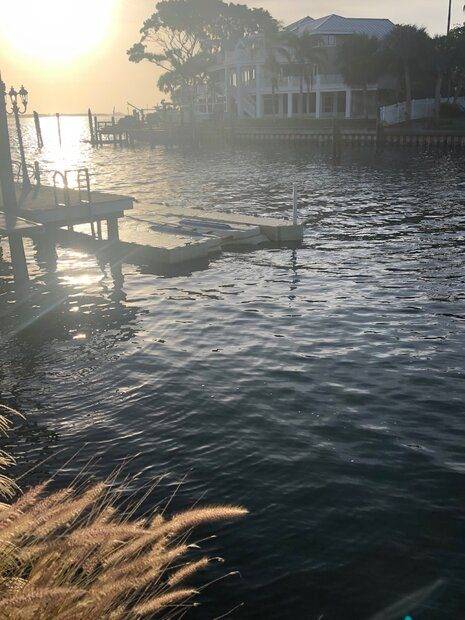

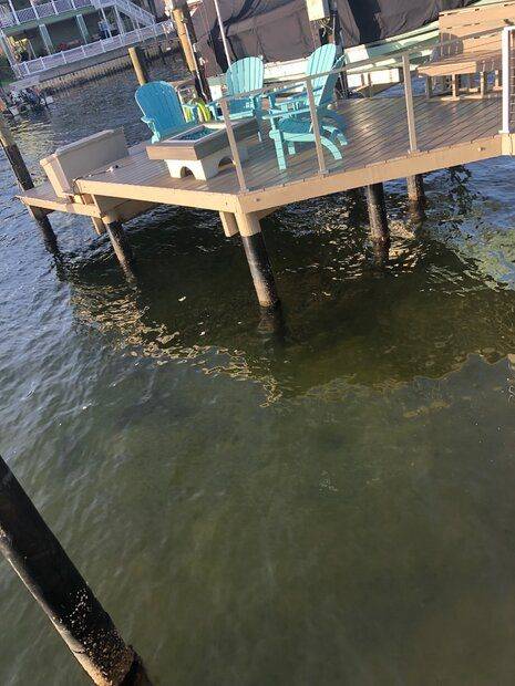

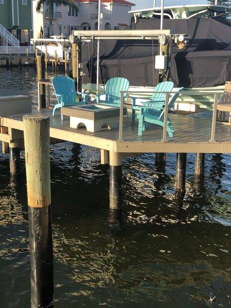

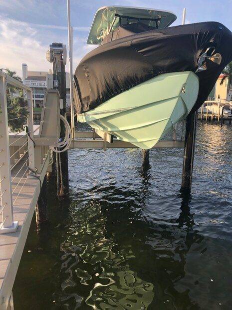

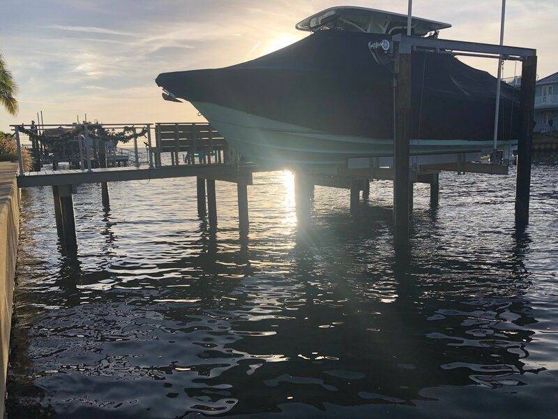

Again, I'm appreciative of the creative input, ideas and comments. My intention of posting this thread was to gain insight from higher-level minds than mine on the "hardware specifications" that would allow this project to work (example: 110v 1/2HP motor coupled with a 25 ft-lb worm gear reduction gearbox). I am a 30-year state licensed Contractor ... I get liability, risk, fail safes, safety factors, etc. Anything I build will be overkill. I'm just unsure how to "dial in" the "calculated" design hardware needs. With that knowledge, I could add overkill to the hardware. I am attaching photos. You will see my next door neighbor's floating platform ... it requires a gang-plank to access it as the tides rise & fall. One of my "must-haves" is a platform that can become a continuation of my stationary dock (same level). Thus, no floating docks. You'll see my existing boat lift. It can be raised/lowered to avoid the waves or allow passengers to board from the dock level. The area on the left side of the stationary dock is where I plan on putting the powered-lift platform. In closing, I appreciate the opportunity given to me to gain knowledge from your Forum. I do apologize if the information I'm seeking is "outside" the scope of typical discussion of your group. Enjoy the Holidays and thank you.

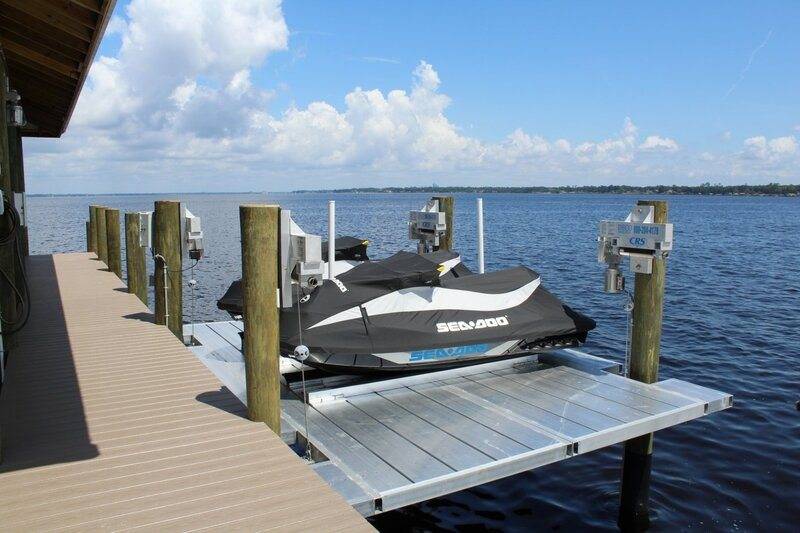

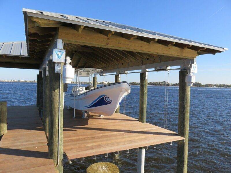

Pushed the research a little bit and I found this:

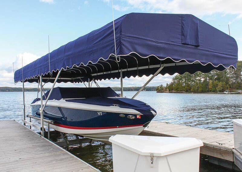

Isn't that what you want (a little smaller)? For the bigger boats, they seem to use the transverse beams you disapprove. But with a little roof on top, as below, it looks fine to me:
Or for a lower budget, a nice little canopy to hide everything (not the same boat lift, but you get the idea):
Best of all, these systems are from a business in Safety Harbor, Florida! Even if you want to do it yourself, at least discuss with them to see how they do it.
Thank you Jack that PWC lift platform is EXACTLY what I have in mind. I will definitely get in touch with that company. We have many many docks and lifts in my area and I have not seen one of those. It might just be a new business venture for me :))
Our neighborhood/county does not allow canopies or roofs over docks or lifts (blocks neighbors' water view).
