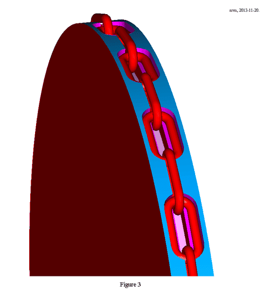

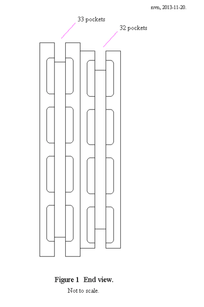

By looping the chain over a top sprocket you halve the chain strength requirement and halve the gearbox ratio required to 644.33
By using a differential pair of sprockets say 32 and 33 tooth, you get another factor of 32 reduction to a gearbox ratio of 19.83
So 1 tooth difference in sprocket size divides by 32? Some how that does not seam right to me. Please explain.

Maybe you have not understood differential gears with an endless chain in two loops. The two sprockets are locked together on the same shaft so one revolution of the sprockets takes in 31 links but releases only 30 from the supporting loop. That shortens the loop of chain by one link per rotation of the sprockets.
You have the two falls of the supporting chain loop, not just only the one supporting the load. The chain shortening is in a loop of chain so you keep the factor of two reduction by having an idler. It also halves the weight of the chain required.
If you put the differential pair at the top and the idler at the load then you can drive the idler to lift the load if you do not want to drive the differential pair above.
Another advantage is that you can use safer lifting chain that is much stronger and cheaper. Link chain is less likely to run without motor power than roller chain. Because it is easier to lubricate and is less liable to damage than roller chain it is not so certain to result in a catastrophic failure later. Remember, a chain is as strong as it's weakest link.

the differential sprockets would need a different length chain for each different lifting height. Unless you know a way to magically grow and shrink a welded link chain. : )
With the differential pair at the top and the idler supporting the load there is one loop under tension and another loop hanging freely below. The length of the endless chain remains fixed. To lift 6 metres or less requires 12 metres of chain closed into a loop.
I am not in the US so I don't have a US chain sprocket supplier there. You can do a google image search for "round link chain sprockets". Take a look at these.
http://www.pewagchain.com/Products/Forderketten/Kratzerforderketten/Kettenrader-aus-Guss/IR-Zahnkettenrad-%282%29.aspx
I have made chain sprockets by cutting a deep groove in the periphery of a wheel for the chain edges and then milling recesses for the links with a circular cutter.
rbees: I agree with the post by Baluncore. Make the two integral pulleys shown in the attached file out of a solid block of mild steel. The two pulleys are integrally connected together at their interface, because they are made from a solid block of steel. (Diagram not to scale.) The pulleys shown in Figure 1 have a plain through-hole (not shown) through their center, so that they spin freely on your steel axle. The bottom (movable) pulley (not shown) can be any kind of pulley (pocket, toothed, or plain); probably plain might do (?), but I will defer to Baluncore on that.
First, find the minimum chain size to give you a high factor of safety on one half of your lifted load. Half would be a chain tensile force of 2224 N. Once you get the exact minimum chain dimensions, then you can design and size the pulleys shown in Figure 1. You can also size the axle. To lift your load 4.90 m, I have not yet computed exactly the minimum length of chain you need to purchase. Once you give us all the exact dimensions, we can compute the input force required to lift the load.
Notice that you do not even need to use a motor. Using the above system, you would be able to lift your 454 kg mass by pulling on the chain with something like a mere 67 N (?) of input tensile force, neglecting friction (although I did not check the exact input force yet; and we need to include friction).

The attached files, Figures 2 and 3, show a crude example of the pulley in post 21, without, and with, a chain on it. This pulley uses a 4.0-mm-diameter annealed stainless steel 304 chain, having a chain pitch of 23.9 mm. This chain has a working load limit of 2250 N, which is ample for your application. This particular pulley has 40 pockets. The 40-pocket pulley diameter, at the chain centerline, is 303.68 mm.
The diagrams show sharp corners, for simplicity; i.e., the edges and corners are not tapered and rounded yet. The diagrams do not show the integral, smaller, 39-pocket pulley yet.
If you could find this pulley to purchase it (including the 39-pocket pulley), instead of fabricating it, that would be great. I currently do not think chain tangling would be an issue.
If desired, you could operate the pulley remotely, by adding another pulley (spool) to it, which has a long cord wrapped around it. Then, to operate the pulley, you just pull the cord, remotely, applying only about 70 N (?) of input tensile force.
With a differential pulley the number of pockets decides the gear ratio. 40 pockets coupled directly to 39 pockets will differ by one link pair for every 80 links moved, or one full turn of the sprocket pair.
If the motor driven idler then had only 4 pockets, (that is a small square shaft with a simple peripheral groove turned in it on a lathe), then each turn of the idler would move 8 links. The gear ratio would be one link pair shortening of the lifting loop for each turn of the 40 pocket sprocket, which would require ten turns of the square idler sprocket. The tension loop, (two falls), will therefore lift one link only per ten turns of the idler. The gear ratio improves with shorter link chain.
A gear motor turning a 4 pocket sprocket will be a bit lumpy, but those square sprockets work well on normal chain blocks and they are trivial to make from square stock in a lathe.
Baluncore: My mistake. In post 24, I counted the round link chain 90 deg links as a "pocket," loosely speaking, which is wrong. Therefore, the example pulley shown in post 24 is currently a 20-pocket pulley.
I wish someone could find round link chain having a working capacity of 2225 N, and having a much shorter chain pitch than what I used in post 24. Then I could increase the number of pockets up to your original 33 pockets, with 32 pockets for the smaller pulley.
The cord I mentioned in post 24 can be operated remotely either by human or machine. Therefore, if machine operation is needed, no problem there.
