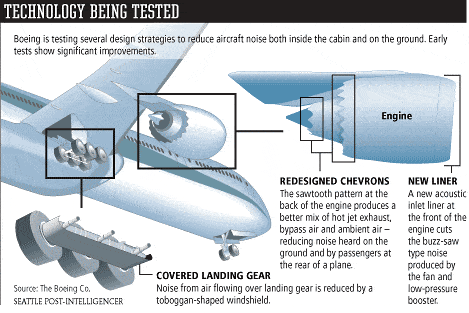

FYI:
Boeing makes 'quiet' advances
Noise-reduction efforts pay off at remote airfield in Montana
By JAMES WALLACE
SEATTLE POST-INTELLIGENCER AEROSPACE REPORTER
http://seattlepi.nwsource.com/business/236095_quietjet11.html
During tests at the Glasgow site with a 777 in 2001, Boeing found that two engines equipped with chevrons made no more noise than a single engine without the chevron.
Photo Caption:
Technology being tested on this Boeing 777 in Montana is expected to find its way into 787s, due to enter service in 2008, and the 747 Advanced. (August 11, 2005)
Credit: James Wallace/Seattle Post-Intelligencer
