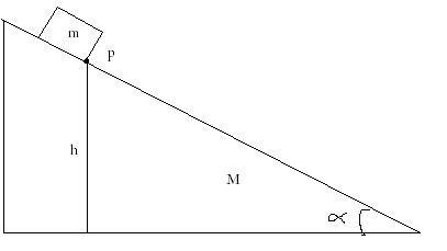

ippo90
A box with mass m is on the top of a slope with angle alpha. Every surface has no friction. Assume that the system starts off from resting position. The start position of the box is P, and has a height h over the horizontal plane. Find the velocity of the block with the slope when the box has reached the horizontal plane ground. The mass of the slope block is M.
-I believe that the relevant eq. are:
m1v1+m2v2=m1v1'+m2v2'
where v1' and v2' are the velocities after a collision etc.
-law of energy: 1/2mv2=mgh
-definitions of cosine and sine
-timeless eq for velocity: v2=vo2+2as
Because we are assuming that the system starts off from resting state, v1 and v2=0
hence mv1'=(m+M)v2' [they will move in different directions]
we want to find v2'. Therefore I tried to express v1' in terms of angle, height. It turned out to be all wrong. What did i do wrong?
I hope someone will help me with this. I've used like 3 hours or so..
thank you

Here you go:
v(box)x = v(rel)cos(a) + v(slope) = Vcos(a) - v2
v(box)y = -v(rel)sin(a) = -Vsin(a)
So rewrite your conservation equations in terms of these.

How about I try to describe it in words? We can worry about a diagram later.
At the time in question, when the box is at the bottom of the slope, let's describe the velocities:
A: The velocity of the slope with respect to the ground is horizontal and to the left. Let's call that v2, going to the left. (Imagine an arrow pointing left, with magnitude v2.)
B: The velocity of the box with respect to the slope is parallel to the slope. Call this vector v(rel) or V: imagine an arrow pointing down and to the right at an angle alpha below horizontal. This is just what you'd see if you were a bug riding along on the slope, watching the box slide; it's sliding down the slope, so of course its velocity is parallel to the surface of the slope. You can easily find the x and y components of this velocity since you know its direction.
C: The velocity of the box with respect to the ground, which we call v(box). To find this, we just add the first two velocities. Since we're adding a horizontal vector to the one slanting down at angle alpha, we end up with a vector that slants down and to the right at an angle greater than alpha with the horizontal. We can easily find the x and y components of this velocity by adding the components of the other velocities: Cx = Ax + Bx, etc.
This is similar to dropping a ball in a moving car. With respect to the car, the ball moves straight down. But with respect to the ground, the ball has an additional velocity due to the motion of the car itself.
I wouldn't get too concerned with visualizing all the details. What matters is that we can deal with things analytically.
The key is to realize that all our equations for energy and momentum conservation must use the speeds with respect to the ground. And we know how to find those and their components.
Let me know if this makes sense.
That was a wonderful explanation, now everything makes sense!
earlier I thought that v(box) was pointing the same direction as the slope, and v(rel) was pointing with ''the angle + a little more''.
now I will try and see if I arrive at the correct answer=)
