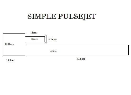

This is the simplest pulsejet you could make and costs only Rs.110 and has got a good throttling range,which you could see in the video..No need to strain much to start this engine it starts in a single attempt..If anyone need to make this design please reply here..Thanks for watching see you all in the next pulsejet video..

this is valveless so no problem for us,no need to make valves:cool:..here is the design..All dimensions are in cm..Those are standard pipes so readily available in markets..:smile:
note: place the inlet fuel pipe at a depth of 4.3cm into the intake pipe..The fuel pipe dia is 3mm..
  • Dimensioned schematic titled SIMPLE PULSEJET showing a box 10.16cm high and 15.5cm wide, a short intake pipe 2.5cm long and 13cm wide, a flared nozzle 3.5cm, and a long tube 4.5cm wide and 77.5cm long.

this has really got good thrust,tried to show an cloth near it but i was not able to do it,so much of force from the exhaust pipe..one day i will hook it up to a scale and find out the real thrust..
note: at the end when i tried to show a cardboard the engine got few holes in the welded parts..
