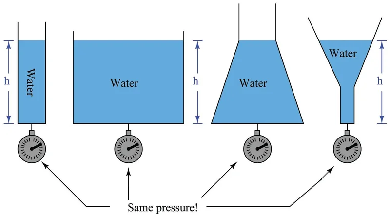

There's a basic difference in the behaviour of solids and liquids in non uniform gravity. Forces (pressure) are transmitted through a liquid in a hydrostatic way but the force through a solid object would be transmitted by electric forces would be transmitted via intermolecular electric cores.
Consider the above diagrams applied to solid and liquids.
The resulting forces / pressures on liquid shapes and solid shapes differ and it's only simple under uniform gravity. That's basic stuff. I'd say that you have to do without the assumption of uniform gravity for any vaguely practical situation. It could cause some interesting divergencies from our regular experiences which could enhance the interest in a story line.
