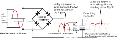

I don't know what is meant by "RC", "RE", "VE", but have a look at this circuit:
To the right, the circuit could be connected to a load like a bulb.
To the left, the circuit is connected to an AC-outlet.
The AC voltage is rectified, creating a DC voltage with a lot of ripple.
To remove (some of) the ripple, a smoothing capacitor is connected between the DC voltage and "ground".
I wouldn't compare the capacitor to a "low resistance path", but to a battery that is charged/discharged, so that whenever the rectified AC voltage is higher than the voltage across the capacitor, the capacitor/battery is charged and vica versa.
Now, the current discharging the battery is limited to the current consumed by the bulb. The current has nowhere else to go, because the rectifier is a one-way path. Hence the steepnes of the rectified AC voltage going toward 0V is limited, so before the voltage reaches 0V, a new rectified AC pulse will occur and the battery will be recharged. In this way the ripple will be decreased because the peak to peak voltage is decreased.
So instead of regarding the capacitor as an AC short circuit, I would regard it as a back up battery, supplying power when needed. You can calculate the needed capacity ( in Ah ) to provide power to the bulb within, say 0.01 s.
