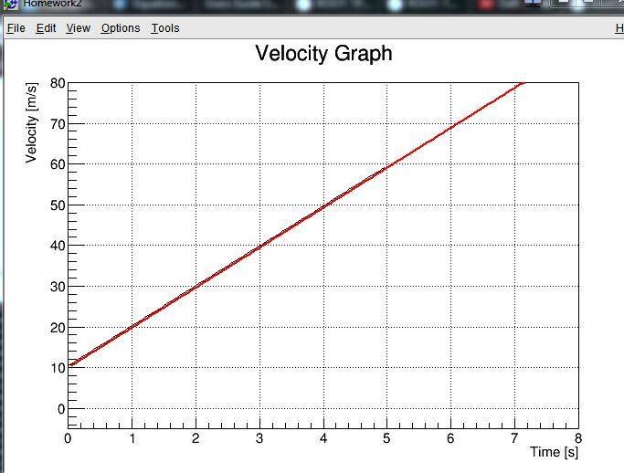

I'm using ROOT (c++) to graph a numerical representation of the equation of motion.
For simplicity, I am using initial velocity = 10 and initial height = 10.
change in time = 0.05
so we find velocity by V_n = V_(n-1) -9.81*0.05
For some reason, this code is not giving me a correct reading.
I graph this against the computational method, and the computational method works perfectly.
Code:
  float x[100], y[100];
  int n = 100;
  float timestep = 9.81*0.05;
  float v = 10;
  for (int i=0;i<n;i++) {
  x[i] = i*timestep;
  y[i] = v-timestep;
  v = v-timestep;
TGraph *gr = new TGraph(n,x,y);
  gr->SetMarkerColor(kBlue);
  gr->SetMarkerStyle(29);
  gr->Draw();

So what you are saying is that I am only observing the v_y(t) element? As my code should represent that part of it.
The x-axis should be time in seconds.
This is an example graph I did earlier based on my computational graph (which works out perfectly).

One other thing -- declaring timestep like this is not a good idea:
Keep the 9.81 constant out -- just make the time steps actual time intervals, and use the constant when you calculate the values in your x and v arrays. And for vertical distances, I would definitely use y, not x. That confused me for a bit.

You've incorporated the acceleration into your timestep variable, no doubt as a nod to efficiency so as not to perform the multiplication g*Δt on each iteration. But you've used timestep to keep track of the time, too.

Excellent guys!
That does seem to be the issue! Time for me to get back to work on this, I'll report back if that was the problem!
@Mark44 thank you for the remarks there. I will apply them to my code once I have a working product as right now, things are a bit of a mess :). Coding the night away.
Looking good guys! That was the problem!
