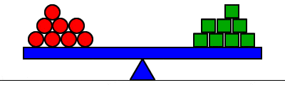

Rather than the bathroom scale, perhaps a seesaw is a better illustration:
The blue seesaw beam is clearly able to rotate about the fulcrum (the blue triangle), and if the masses resting on the seesaw beam are evenly balanced, there will be no rotation clockwise or counterclockwise. The fulcrum point is also supporting the weight of the red barrels and the green boxes (not to mention the weight of the beam itself), otherwise, the whole apparatus would be moving in some direction.
That's what we mean when we say something is in static equilibrium: there is zero net force and zero net moment acting on the system.
