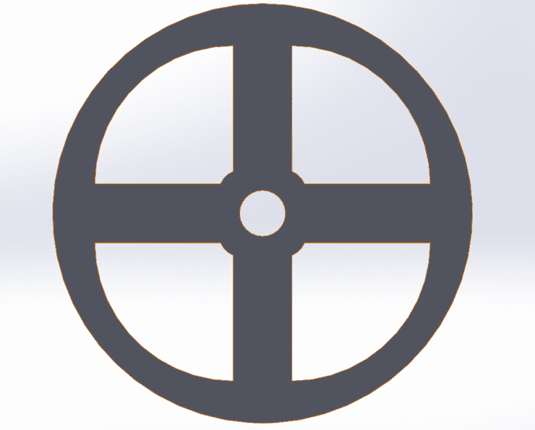

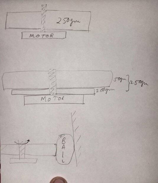

Assume the top image to be the simple version of the wheel configuration and the lower one to be the proposed way of wheel arrangement. In the newer version i want to use a heavy metal plate of approx 200gms and a wheel of 50gm instead of a heavy 200gm wheels due to sourcing issues.
This is what the metal plate looks like. The metal plate is about 100mm in diameter and the wheel is 114mm in diameter. My calculations are as follows:

I haven't checked everything, but it looks like you are saying ALL of the wheels energy converts to ball kinetic energy? Is the motor on or off during launch? What is the wheel speed after the ball is launched?
I have designed the control electronics to detect the moment of the energy transfer and immediately cut off power(the motor stops immediately) and after the ball is launched they spin up again.
Or I can also do the motors spinning at a constant RPM throughout.
I'm asking for advice about what should I do to achieve the best results.
(I'm an electrical Engineer and thus have very little knowledge about the mechanical aspects; thanks for your help)

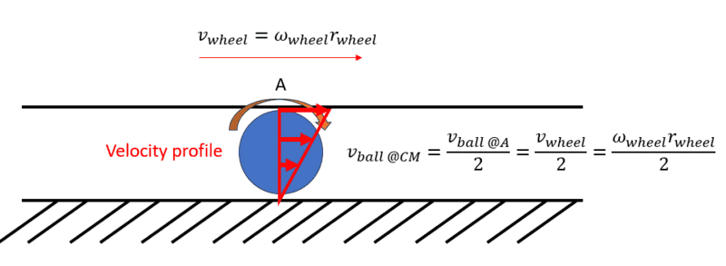

@SMKJ you have mentioned conservation of energy. Although it's true energy will always be conserved (in classical physics) there need to be the right conditions for the transfer of energy to happen as you intend.
First of all, you system will be governed by friction. It is through friction that the kinetic energy will travel from the wheel to the ball. Make sure there is enough friction so you can make some simple assumptions such as the rim velocity of the wheel being the same as the rim velocity of the ball. You may achieve that by increasing the pressure or the friction coefficient. Also, if you prolong the contact between the ball and the wheel you will give the ball more time to accelerate. That'd be achieved either by not trying to accelerate the ball too much or by having a very big wheel so it's in contact for a longer time.
Secondly, having a stationary wall might give you some trouble because the ball will come out with a spin and because the output velocity will be decreased. Here is a simplification of a system like that:
If you have two wheels you won't have to deal with those problems. Your velocity profile will be constant instead of a triangle so the center of mass will move at the same speed as the rim speed of the wheels. Also, the ball will come out without spinning. You don't necessarily need 2 motors. You can simply link them mechanically with gears.
I would keep the motor running at a constant RPM. As you supply power to the motor, the wheels will stabilize at a certain speed. You then feed the ball and the sudden load might decrease the wheel' speed a little but the effect would be minimized by having bigger wheels with greater inertia.
