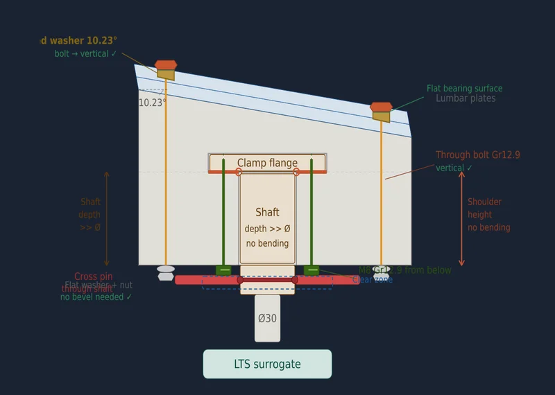

Custom 10.23° beveled washer between bolt head and inclined lumbar plate — does it preserve the inclination angle or cancel it? Also: bolt hole becomes elliptical on inclined surface — washer OD sizing implications at 120 kN
*Background**
I am designing a lower torso surrogate adapter for crash test dummy drop tower testing. The assembly works as follows:
- The **lower torso** (EN24T wedge) is bolted **flat** to the drop tower floor
- The top face of the wedge is inclined at **10.23°** — this is intentional, it replicates the anatomical lumbar inclination
- The **upper torso** sits on top of the inclined lumbar plates at 10.23°
- The two are joined by **M16/M20 Gr12.9 through bolts** passing through both lumbar plates and the wedge
- The bolts must carry **120 kN** impact load
**The Problem**
Because the lumbar plate surface is inclined at 10.23°, the bolt holes are drilled perpendicular to that inclined surface. This means:
- The bolt axis is **NOT vertical** — it is at 10.23° to vertical
- The bolt head bears on the **inclined surface** at an angle
- Without correction, the bolt bends on tightening → stress concentration → bolt fails below rated load
**Proposed Solution**
Add a **custom machined beveled washer** (10.23° cone angle, EN24T, OD ≈ 40mm) between the bolt head and the inclined lumbar plate surface.
The beveled washer:
- Has an **angled bottom face** matching the 10.23° inclined plate surface
- Has a **flat top face** giving the bolt head a perpendicular bearing surface
- Makes the bolt **perpendicular to its own bearing surface** — full preload, no bending
**The Question**
My supervisor flagged a concern: does adding the beveled washer change or cancel the 10.23° inclination of the upper torso?
My understanding is **no** — here is my reasoning:
1. The lower torso wedge is already fixed flat to the floor — the 10.23° inclined top face is fixed geometry, it does not move
2. The upper torso sits on that inclined face — it is at 10.23° regardless of what the bolts do
3. The beveled washer only corrects the **bolt-to-bearing-surface relationship** — it does not change the geometry of the interface between upper and lower torso
4. The inclination is defined by the **wedge geometry**, not by the bolt angle
In other words: the beveled washer makes the bolt work correctly **on the inclined surface** — it does not flatten the surface.
**Can anyone confirm or correct this reasoning?**
And as a secondary question — is a custom machined EN24T conical washer the right approach for 120 kN at 10.23°, or is there a better standard solution (DIN 6319 spherical washer pair, for example)?
Thank you

How will you prevent the beveled D washer from rotating during assembly?
The wedge angle of 10.23° will cause the D wedge to move sideways, until the hole in the D wedge contacts the shank of the bolt. What prevents the D wedge from sliding sideway with the bolt head, until the bolt shank is in contact with the lower side of the hole? If that does not happen during assembly, it will happen later during a drop.
As a guide to wedges, Tan(10.23°) = 0.180 ; which is the minimum coefficient of friction needed between the wedge and the surfaces, that will prevent the wedge from being ejected, until being held by the hole contacting the shank.
The relative position and alignment of the two lumbar plates being clamped, should be fixed not by plain bolts alone, but by dowels, or by reamed holes with fitted bolts.

Why did you call the washer "conical" in two occasions?
I can't understand the concern of your supervisor.
Unless I am missing something that is evident to him, I believe that the beveled washer can't affect the 10.23° interface angle between upper and lower torso.
As correctly pointed above, a slight vertical rotation of the beveled washer during assembly can introduce additional great load to the bolt, as the top surface will not be perpendicular respect to the axis of the bolt.

Since you enjoy the capability of machining a recess in the top lumbar plate surface, why not to machine the two holes and two flat circular surfaces, respectively aligned with and perpendicular to the axes of the through bolts?
Without weakening the lumbar plate much (5 mm max deep slanted cavity), that solution would eliminate the need of the two beveled washers, and the problem of the misaligned holes for the bolts.

Why not drill the upper lumbar plate, then provide a shallow counter-bore, in a milling machine set at 10.23°. The bolt head will then seat flat, without any need for bevelled washers, also, the holes will then not be elliptical.
There will still be a shear between the two lumbar plates that will pinch the bolt shank at the interface. That is where two dowel pins, or two fitted bolt shanks in reamed holes are needed to counter the shear and maintain accurate positioning during assembly.

the lumbar plates are **certified crash test dummy components**. I cannot drill, mill, or modify them in any way — any modification would invalidate the certification and compromise the biofidelity of the assembly.
**The question:**
Given that I cannot touch the lumbar plates, what is the best alternative solution to achieve a proper bolt seating on the 10.23° inclined surface?
My current thinking:
1. **Beveled washer** (custom machined at 10.23°) with an anti-rotation feature — a flat or tab on the washer OD registering against a fixed reference to prevent rotation during tightening
2. **DIN 6319 spherical washer pair** — self-aligning convex/concave pair, no custom machining, no rotation problem, off-the-shelf standard part
Is the DIN 6319 spherical washer pair a reliable solution at 120 kN on a 10.23° inclined surface? Or is there a better established approach for this constraint?

Any bolt that clamps a wedge, or passes diagonally through an interface, will have shear forces at some boundaries. That will cause the shank of the bolt to press on the edge of the material.
120 kN is significant, but the method to use will depend on the diameter? of the bolt and the thickness? of the lumbar plates.
It is not clear from your diagram in post #1, what the lumbar wedge really is, or how it is attached to the bottom lumbar plate.
Why pass through bolts through both lumbar plates and the lumbar wedge, when you have two separate situations.
If you certify the bottom lumbar plate, but not the top, then that simplifies the solution. Bolt the two lumbar plates together, but with an adaptor of some sort below the bottom plate. Then bolt the adaptor to the bottom of the wedge.

Thank you Baluncore for the detailed feedback, and I sincerely apologize for my late reply — unfortunately it was beyond my control.
To clarify my design constraints and solution:
1. The upper torso plate is the certified component — not the bottom. It is made from SAE 1010 steel, has pre-drilled holes at 10.23° inclination, and cannot be modified in any way.
2. Since I cannot touch the upper torso, all my modifications are on the wedge only. My solution was to design the wedge at the exact same 10.23° inclination as the upper torso flange. This means both mating surfaces are parallel, the bolt passes through both at the same angle, and there is no relative angular difference at the interface — therefore no shear force is introduced between the two parts.
3. To address the bolt head bearing surface, I am using NF E 27-681 bevel washers (equivalent to DIN 435, IPN Dn10), which restore a perpendicular bearing surface for the bolt head, ensuring the bolt is loaded in pure tension.
4. Regarding your suggestion to glue or solder the bevel washer — I think this is actually a good idea, not for structural purposes, but simply to prevent the washer from sliding or rotating on the inclined surface during assembly before the bolt is fully tightened. A small amount of adhesive or low temperature solder would keep it correctly positioned without compromising the mechanical integrity of the connection.
5. To further address the shear and sliding concern at the plate/wedge interface, I am also considering machining a pocket (recess) on the top surface of the wedge matching the profile of the upper torso plate. This would mechanically locate the upper torso, transferring shear forces through the pocket walls rather than through the bolt shanks alone.
Would you see any remaining concerns with this configuration?

I would need several diagrams that show the detailed structure before I gave it a tick, but you are now more informed, and so better able to analyse the situation. I think you may now be at the point where you need to build one, put it to work and test it.
Perfection is the enemy of progress.
I will make a detailed a diagram ASAP as your input is very important to me.
