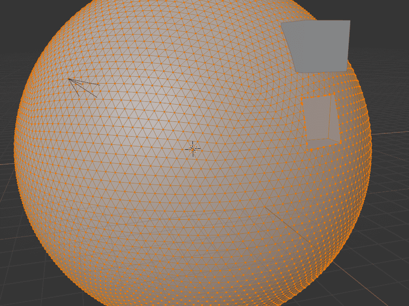

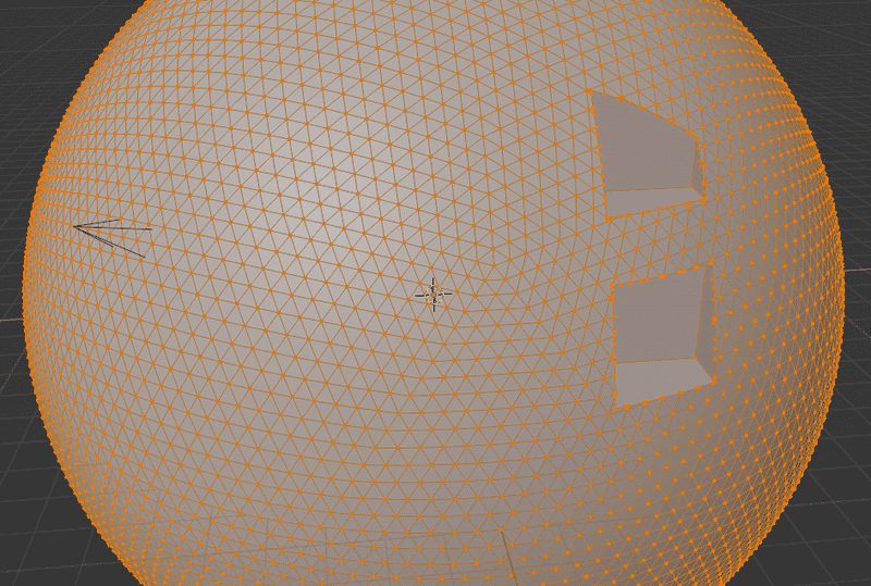

Take a look at the pictures attached, I am guessing 'interface construction' is the algorithm that results in what we see in the pictures. How about area calculation? Is there any literature on how to find the intersection and area in the general case? The intersection looks like a simpler problem, the area seems difficult.
  • Wireframe render of a triangulated sphere in orange vertex dots on a grey surface, with two rectangular cutout patches on its right side and a small wireframe arrow at left.
  • 3D viewport showing a wireframe triangulated sphere with orange vertices, with a grey rectangular prism partly intersecting its surface at the upper right.
