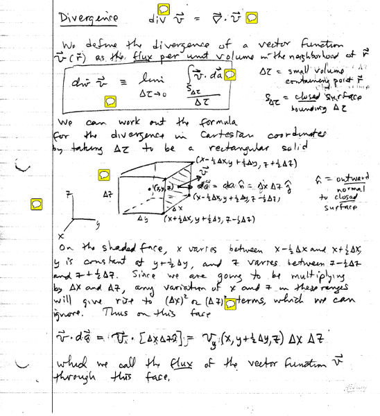

This is a coursework problem. I am having issues understanding the concepts on this one topic - divergence and how it relates to flux. I have attached screenshots that honestly give the best representation of my issue but I will set up the issue I am having none-the-less:
We are trying to find an equation for the divergence. He gives that div v = lim τ->0 [itex]\frac{\oint<b>v</b>dot d<b>a</b>}{Δτ}[/itex]. So then he sets up a rectangular prism. He didn't go through this with us as he just posted in notes scanned. So v is some vector function da is the normal area to the right plane. In the image he also puts a bunch of points. I guess he choose an x,y,z point contained in the rectangular prism (FIRST QUESTION: Does the x,y,z coordinate location matter? Could I have done it in one of the quarters of the shape rather than in the middle?). He then talks about how x,y,z vary in that right plane.
SECOND QUESTION: why does he say "Since we are going to be multiplying by Δx and Δz, any variation in x and z in these ranges will give rise to (Δx)^2 or (Δz)^2 terms, which we can ignore.
He then sets up v dot da as the y component of it (parallel to the normal of that plane.
I think I should leave it there actually because I feel once I understand the second question, that will give me clues to what is going on. I have been trying to figure this out for quite sometime now and I am lost on how he went from the v-da to the stuff on page 22. If you look later on page 22 at the rectanglular prism that is sliced on a diagonal that is a homework problem we have to do (show that it doesn't matter what shape we choose). I want to try that on my own but I need to know how he set his up first. Any help would be greatly appreciated

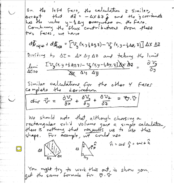

  • Handwritten notes deriving the divergence of a vector field in Cartesian coordinates, including a rectangular box with a shaded face and outward normal; written formulas read div v = lim (1/Δτ) ∮ v · da and v · da = v_y(x, y+½Δy, z) Δx Δz.
  • Handwritten derivation of divergence in a rectangular box: flux through left and right faces combined, dividing by Δx Δy Δz, taking the limit to get ∂v_y/∂y, ending in div v = ∂v_x/∂x + ∂v_y/∂y + ∂v_z/∂z.

Yes, you could have located (x,y,z) at one of the corners. If you go through the derivation with this assumption, you'll get the same result.
Concentrating on just the x-direction for now, we have to first order that the quantity ##v_y## will be some value plus a deviation proportional to ##\Delta x##.
$$v_y(x+\Delta x/2, y+\Delta y/2, z) = v_y(x, y+\Delta y/2, z) + \alpha \Delta x$$ This is just a Taylor expansion. When you multiply by ##\Delta x##, you get
$$v_y(x+\Delta x/2, y+\Delta y/2, z) \Delta x = v_y(x, y+\Delta y/2, z)\Delta x + \alpha (\Delta x)^2.$$ In the limit ##\Delta x \to 0##, the second-order term become negligible compared to the first-order term. That's why you can just drop it right from the start. The same thing happens if you consider what happens in the z-direction.

If you want to be meticulous about the approximations, you can approach it as follows.
The flux through the right face is given exactly by
$$\Phi = \int_{z-\Delta z/2}^{z+\Delta z/2} \int_{x-\Delta x/2}^{x+\Delta x/2} V_y(x',y+\Delta y/2, z')\,dx' \,dz'$$
Introduce new variables of integration ##u = x' - x## and ##v = z'-z##. So,
$$\Phi = \int_{-\Delta z/2}^{\Delta z/2} \int_{-\Delta x/2}^{\Delta x/2} V_y(x+u,y+\Delta y/2, z+v)\,du \,dv$$
Now, follow vela and Taylor expand the integrand about the center point ##(x,y+\Delta y/2, z)##
$$V_y(x+u,y+\Delta y/2, z+v) = V_y(x,y+\Delta y/2, z) + \frac{\partial V_y}{\partial x}(x,y+\Delta y/2, z)\,u + \frac{\partial V_y}{\partial z}(x,y+\Delta y/2, z)\,v + \cdots $$
The first term of the expansion will lead to the desired result. The second and third terms of the expansion actually yield zero because
$$\int_{-\Delta x/2}^{\Delta x/2}u \,du = 0 \;\;\text{and}\; \int_{-\Delta z/2}^{\Delta z/2} v \,dv = 0$$
The next higher order terms in the expansion will be quadratic in ##u## and ##v##. The ##u^2## term will lead to a contribution to the flux proportional to
$$\int_{-\Delta x/2}^{\Delta x/2}u^2 \,du = \frac{(\Delta x)^3}{12}$$.
And so forth. These higher order terms will go to zero when taking the final limit.
thatguy14 said:
Sorry not the taylor series thing, what rule allows you to bring out the deltax/2 from the vector?
That is the Taylor expansion.
$$f(w) = f(w_0) + f'(w_0)(w-w_0) + \cdots$$ In the derivation you have ##w = x + \frac{\Delta x}{2}## and ##w_0 = x## so that
$$f(x + \frac{\Delta x}{2}) = f(x) + f'(x)\frac{\Delta x}{2}+\cdots$$
