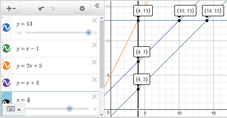

The volume of a rectangular prism can be represented by the polynomial
V(x)=2x^2+9x^2+4x-15
a. The depth of the tank is (x-1) feet. The length is 13 feet. Assume the length is the greatest dimension. Which linear factor represents the 13 ft?This is probably a really easy question but I am so confused reading it, I really need help on how to do these kinds of problems.

I am assuming the volume is the cubic polynomial:
$$V(x)=2x^3+9x^2+4x-15$$
We are told the depth is $x-1$, so we know $1$ is a zero of the polynomial...so let's use synthetic division:
$$\begin{array}{c|rr}& 2 & 9 & 4 & -15 \\ 1 & & 2 & 11 & 15 \\ \hline & 2 & 11 & 15 & 0 \end{array}$$
So, we now know:
$$V(x)=(x-1)\left(2x^2+11x+15\right)$$
Now we need to factor the quadratic factor...
$$V(x)=(x-1)(2x+5)(x+3)$$
What value of $x$ makes the largest factor equal to 13?
Re: Help with an equation problem
As a followup, we can determine which value of $x$ makes the largest factor 13 by looking at the following graph:
We can easily see that when $x=4$, the largest linear factor is $2x+5=13$. The dimensions of the tank are:
$$3\text{ ft}\times7\text{ ft}\times13\text{ ft}$$
