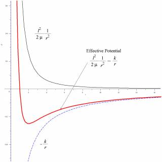

If we consider the effective potential plot as a function of radia position, then the circular orbit has the minimum energy (corresponding to one radial position) and the elliptical orbit has some larger energy so that it has two 'radial limits', at least that's what I have been taught. Is this not right?

You're writing about this plot:
That's a useful but potentially misleading diagram. It does not mean what you think it means. In particular, it does not mean what you wrote in the opening post, "This concerns me because the energy of an elliptical orbit is greater than that of a circular one."
Imagine a particle orbiting circularly far removed from the central body and another particle orbiting circularly close into the central body. That remote particle has much greater mechanical energy than does the close-in particle. The mechanical energy of the remote particle is almost zero; give it just a tiny nudge forward and it will escape. The close-in particle has a large negative mechanical energy. Give it a tiny nudge forward and it will now have a slightly elliptical orbit. That tiny nudge was a just tiny nudge. It didn't suddenly gain so much energy that it exceeds that of the remote particle.
That red curve is the effective potential energy for a given angular momentum. A different angular momentum results in a different effective potential energy curve.
Somewhere in your text or your notes you should have a derivation for the total mechanical energy for an orbiting object. It should be along the lines of ##E=-\frac {GMm}{2a}##, where ##a## is the semi-major axis of the orbit.

So, analysing the effective potential curve:
The elliptical orbit has a smaller angular momentum (as I calculated above) - incidentally is there a more obvious way of seeing that an elliptical orbit of semi major axis R has a smaller L than a circular orbit of radius R without finding the velocity at rmax?
So it's effective potential curve shifts downwards. Then it's maximum radial position has to coincide with the radius of the circular orbit (the trough needs to move left as well which the smaller L takes care of). This then implies their energies will be equal. This also agrees with your formula for the energy, so all is good in that sense.
However back now to my original scenario:
At rmax, both orbits have equal energy. dr/dt=0 for both, and the both have the same PE. This implies their tangential velocities must be equal so their energies are. However they are not as I calculated. So the situation still hasn't been fully resolved (maybe what I wrote above was wrong?).

No, they don't. The first orbit has a semi-major axis of 24,000 km. The second, a semi-major axis of 40,000 km. Energy is a function of the gravitational parameter and semi-major axis only. The transfer orbit (the elliptical orbit that took the vehicle from 8,000 km to 40,000 km) has less (more negative) energy than does the outer circular orbit.
This is admittedly a bit confusing. (Some say more than a bit.) When the vehicle is orbiting circularly at 8,000 km it has to fire its thrusters to increase its velocity to put it on that transfer orbit. Once the vehicle reaches apogee, it has to fire its thrusters to increase its velocity once again to put it in that new circular orbit. The most confusing part: The vehicle is now moving slower than it was when it started orbiting circularly at 8,000 km.
I'm not making this up. Google the term "Hohmann transfer".
In many cases a Hohmann transfer is the most energy efficient means by which a vehicle can move from one circular orbit to another. But not in all cases! For something even more confusing, suppose you want to transfer from a close-in circular orbit with radius ##a## to a circular orbit with radius ##12a##. Now it's better to make two transfer half orbits. The first takes the vehicle from a distance of ##a## to a very, very large distance. The second brings the vehicle back to the target orbit. Finally, at the target distance it fires the jets one last time to circularize. This is a bi-elliptic transfer. But you don't have to worry about that for this course.
