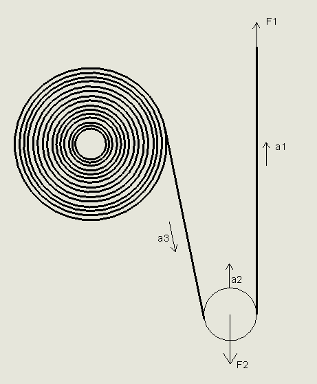

I'm making a tube uncoiler and I'm trying to find the acceleration of the tube at the reel (a3) can someone help me with this.

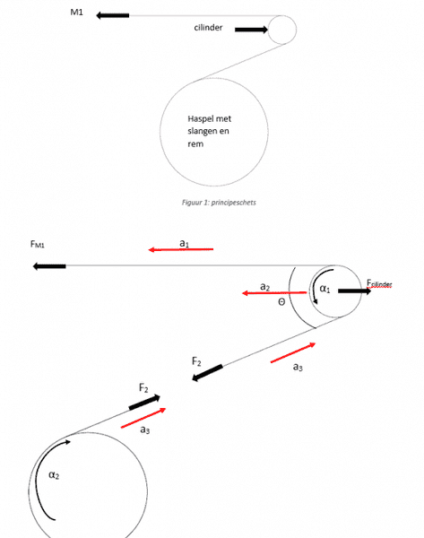

This uncoiler is not a steady state process. The uncoiler stands still and gets accelerated for a certain time because of F1 pulling the tube.
During this period, the dancerrol will move with acc. a2.
I'm trying to figure out what the acceleration of the reel is during the acceleration of the uncoiling process.

yes I use a pneumatic brake, but during the acceleration time I don't use the brake. The force F1 is to accelerate the the inertia (reel+(dancerrol)?). You can assume there is no friction.
Is it correct to say that a1=a3+a2?
