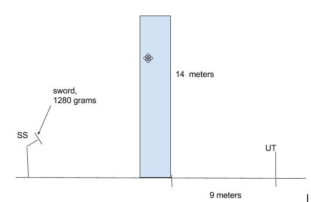

UT has jumped over a wall and unfortunately for her, she forgot to bring her sword. Her friend SS decided to shoot the sword to her with a bow. He can bend a bow and arrow so that it gets a potential energy of 179 Nm. It seemed that Ut landed 9 meters behind the wall; a house was standing in the way. We know that the wall is 14 meters high. So, from which angle must SS shoot the arrow so that UT receives her sword quietly in her hands? ( Both Ut and her hand will be 2.4 meters above ground when she receives the sword, the sword weighs 1280 grams). Do we need more assumptions to solve the problem?
Diagram of a wall 14 meters high in a shaded rectangle, with a sword labeled 1280 grams at left near SS, and UT on the ground 9 meters beyond the wall.
W= mgh
I started by calculating how much energy that was needed to get the sword to the top of the wall.
W= 1.28 kg * 9.82 *14 = 176 Nm. He can bend the bow with a 179 Nm potential, that means he can get it over to the wall.
I couldn't figure out more than this, don't really understand how get the right angle and what other assumptions might be.
Could other assumptions be the length of UT and SS?

You are given the height at which UT is to catch the sword, but not the height it is fired from.

That doesn't help much. If all the energy were used merely getting it there then there would no KE left to propel the sword the remaining horizontal 9m.
You have to start by assigning some variable names to unknowns. We might be able to eliminate these later.
What extra parameters do you need in order to deduce the trajectory?
Well, if we suppose that SS height when he realizes the bow is 2.6 meters. That would help us in reducing the work needed to get the sword to the top of the wall (143 Nm). Still, as you've said, the energy left(36 Nm) is not enough for the 9 horizontal meters.
The first unknown variable is the angle from which the sword should be shot. we can call it . Other variables might be how far SS should stand away from the wall, β. I am not sure, but if he is standing in the right position, it might reduce the work needed.
Is there a specific equation that might help with reducing the trajectory?
Are you sure? How did you deduce that?

I could deduce the energy by subtracting the height that assumed the height of SS when he shoots the bow(2.6). 14-2.6= 11.4 meters
W= 11.4*9.82*1.28≈143 , 179-143= 36 Nm left.

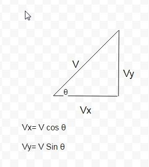

If the launch velocity is v at angle θ to the horizontal, what are the horizontal and vertical components?
Let the top of the wall be y1 above the launch point, horizontally x1 from the launch point, and suppose it takes time t1 to just scrape by it. What two equations can you write relating these five variables?
I can start by figuring out the vertical and horizontal components. If V is the launch velocity, then the vertical component is V, and the horizontal is Vx. If so, then the first equation might be the angle θ, which would be tan θ = Vy/Vx. Another equation related to this is V^2 = Vx^2 + Vy^2.

Perhaps your physics teacher is assuming that the least speed is needed if clearing the wall is at the highest point of the trajectory. That might be true but it is far from obvious. Although standing a little closer to the wall, so that the highest point is a bit beyond the wall, requires a greater vertical velocity it needs a lower horizontal velocity. One can imagine that might be a lower speed overall.
I tried a simple example. Wall height 1, distance beyond wall to target = 4, g=9.81. Launch and land at height 0.
Using the naive (symmetric) solution of launching from distance 4 in front of the wall, so that peak height is at the wall, gives
Launch angle = 26.6 degrees, launch speed = 9.9m/s.
A better solution is to stand much closer, distance 0.96m.
Launch angle = 52.0 degrees, launch speed = 7.1m/s.
In general, if the wall is height h and the distance beyond the wall is d then the optimal angle is (π-atan(d/h))/2, while the naive solution is atan(2h/d).
So unless your physics teacher has some very clever method, I do not see that there is a much easier way than the two-stage analysis.
That said, for the problem as given, the difference turns out to be quite small. The naive solution gives 16.18m/s, while the optimal solution gives 16.06m/s. The larger the ratio of horizontal to vertical the greater the benefit of the optimal solution.

If the throw speed is v and the angle is θ, what are the horizontal and vertical components?
If the height to be cleared is h (=14-2.4m, but just leave it as unknown h in answering), with that vertical velocity, how long will it take to reach its maximum height? Get an equation of the form t=some function of v, θ, h.
How far will the sword have traveled horizontally in that time? Get an equation in the form x=some function of v, θ and h.
Knowing x=9m, what equation do you get for θ?
The vertical component is Vy, the horizontal is Vx.
As I am trying to figure out the time it takes to reach maximum height, I am only taking the vertical component into consideration. Using the equation V=Vy-at. In his case is the gravitational power and because the speed at maximum height is 0, I rewrote the equation and got t=V sin(θ) / g. From here I got stuck, I couldn't find a way to calculate the time, Many variables are missing and you mentioned h is supposed to be in the function, but I don't have it in t=V sin(θ) / g.
  • Right triangle diagram with hypotenuse V, horizontal leg Vx, vertical leg Vy, and angle θ at the lower left; below it, Vx = V cos θ and Vy = V Sin θ.
