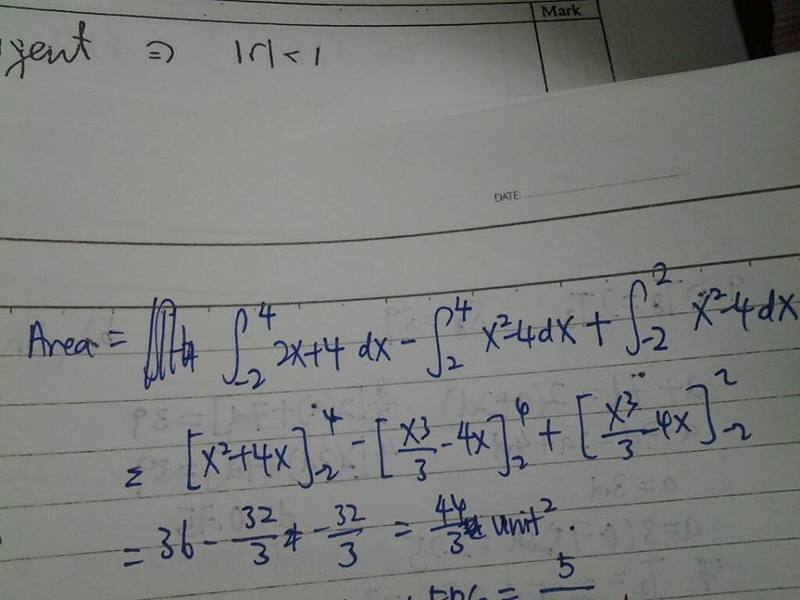

My workings are in the second image. I don't understand why is it wrong.
Since the graph is well below the x-axis, if I integrate it do I get infinity?
(The x-coordinates of P and Q are -2 and 4)
Not if you set it up right.
Areas below the x-axis normally come out negative. You need to decide how to divide the region up so you can integrate in several stages.

Your integral is not set up correctly. In the first line of your work you have three integrals, and one of them is incorrect. Using vertical strips, which you did, all you need is one integral. Throughout the interval [-2, 4], the line is always above the parabola, and the height of a typical area element is (2x + 4) - (x2 - 4). Just integrate this expression and you should get the right answer.

The problem is to find the area bounded by the curves ##f(x)=2x+4## and ##g(x)=x^2-4##
OP did the following:
$$\text{Area}=\int_{-2}^4 (2x+4)dx - \int_2^4 (x^2-4)dx + \int_{-2}^2(x^2-4)dx$$
... the error was that the last integral should have been subtracted, not added.
I had hoped that the "negative area" comment would have caused a re-evaluation of the last term... or, at least, a query about what it means. In this case: "negative of the area".
Since g(x) < f(x), OP could have proceeded just by integrating the difference of the functions, and it would have come out automatically... as Mark44 suggested (described by summing the strips).
It may have been more direct just to ask if the contribution from the last integral should be to increase or decrease the overall area ... and follow up with whether the calculation does this.
I already got the answer right after I read #2 that day.
Didn't expect so many subsequent replies, thanks everyone.
