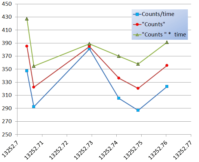

Hello! I want to plot a rate vs energy plot, but I am not sure how assign the bin center. Assume I have 2 data points in the bin (so 2 energy values), ##E_1## and ##E_2## and the first one has 100 counts measured over 10 seconds (so a rate of 10 counts/s) while the second one has 2000 counts measured over 100 seconds (so a rate of 20 counts/s). If I combine them, I get a rate of 2100 counts per 110 seconds i.e. 19.1 counts per second. But I am not sure what energy to assign to this bin. Would it be ##(E_1+E_2)/2##? Or a time weighted average ##(t_1E_1+t_2E_2)/(t_1+t_2)##? Or something else (maybe related to the error on each bin i.e. ##\sqrt{N}##? Thank you!

That's an unweighted averageThe math if you insist on merging is simple:
you have ##r_1 = {100\pm\sqrt{ 100}\over 10}## events with ##E_1## per unit of time and ##r_2 = {2000\pm \sqrt{2000}\over 100}## with ##E_2##, so $$ r_E = {\sum {r_i\over \sigma_{r_i}^2} \over \sum {1\over\sigma_{r_i}^2} }$$so a bit more than 19.1 (19.52##\pm## 0.02)
(In other words: the value and the error are mainly determined by the more accurate counting rate that weighs 20 times heavier).
For ##E## you get $$E={\sum {r_i E_i\over \sigma_{r_i}^2} \over \sum {r_i\over \sigma_{r_i}^2}}$$ In other words : as above

Thank you for your reply! I am a bit confused about the way you calculate the rate when rebinning. Why do you use the error in that calculation. To use a toy example numbers: if I know that I have 100 counts in 10 seconds between 0 and 50 (in some arbitrary energy units) and 2000 counts in 100 seconds between 50 and 100, then I know for sure, based on my experiment, that I have 2100 events in 110 seconds between 0 and 100. Why can't I just assign to that 0 to 100 bin a rate of 2100/110? What I am trying to say is that, if I were to decide from the beginning to use bins of 100, that's what I would get: 2100/100. So based on your formula, if I decided to use bins of size 50 and then double the size of the bin, would give me a different result than when I would do directly bins of size 100. That doesn't really make sense to me. Am I missing something?
Ah, I should have heeded @Stephen Tashi 's mildly formulated (thanks steve!) criticism: my interpretation of #1 was that you had exact (i.e. relatively accurate) energies ##E_1## and ##E_2## somewhere in the spectrum, where you measured counting rates ##r_1## and ##r_2##, and there is only one ##E## in the phenomenon. That is indeed a (few) assumption(s) too many. Sorry.
If it's just a matter of merging two adjacent bins with centers ##E_1## and ##E_2## then your new counting rate is indeed ##2100/110## at ##E_1+E_2\over 2##. But why do such a thing and throw away information ? ##100\pm 10## counts/unit t next to ## 200\pm 5## is reason for alarm. Merging the bins sweeps that under the rug.

You must be careful. Look at the example where the rates in the two bins are actually the same. You count for 100 sec in one and 10 sec in the other yielding say 2000 in one and 200 in the other if you combine the counts into 2200 and the times to 110 you get at combined rate of 20 cps which is great. now if we repeat for a count of 2000 in 100 sec and 100 in 10 sec but this rate is not the same as the first bin and combine the two 2200 counts in 110 sec we bet 19 cps. If we would have counted the second bin for a full 100 sec we would have expected 1000 counts. Combining these two rates we get 3000 total counts in 200 sec. giving and average rate of 15 cps !
The lesson is that you should normalize the counting times.That is the rates must be computed from the same counting time.

Take two intervals next to one another. one with N1 counts obtained in t1 sec and the other with N2 oounts obtained in t2 sec. the rates are expected to be different. If I would have measured both intervals simultaneously my rate should have been r1 +r2. It is like two faucets filling the same pail at the same time. If I had two buckets each filled at a different rate r1 and r2 and combined them without knowing how long each faucet was filling the pail how could I produce a combined rate of filling without knowing those times? Even if you told me the sum of the times that would in general not be accurate unless you also were told the ratio of the times. I could fill both pail to the same level one pail slowly for a long time and the other quickly for a short time. If you took the contents of the pail and divided by the sum of the times you would be in error on the low side because you are inadvertently weighing the low rate more.
V1/t1 +V2/t2 = r1 +r2
BillKet said:
I am not sure why would you divide by 2 here, given that in your example you didn't divide by 2 (you got 420 cps, not 210 cps). And basically, if you divide by 2, you do what I am doing already (i.e. (99+101)/(1+1)). So I am not sure what you mean by adding rates, which would be, in this case 99/1+101/1=200/1 cps.
As for the factor two . Adding two rate gives you the rate for an bin width twice the original. If you wanted to use the original bin width as reference then divide by two.. If you merged three you would divide by three. etc.
Make up examples for yourself with different rates and times in each bin. Do your way and then mine.(you have to divide the net rate you get using my way by 2 to compare to yours)

The data gives the rate at each energy interval of which there are say N. When you bin two consecutive intervals you now have N/2 bins. The total rate indicated by the original data is
## R_{total}^{orig} = \sum_{i=1}^{N}r_{i} ##
When you rebin you get
## R_{total}^{rebin} = \sum_{j=1}^{N/2}(r_{2j-1}+r_{2j} ) ##
Rebinning should conserve the total rate ## R_{total}^{orig} = R_{total}^{rebin} ## which is accomplished by adding the rates of the consecutive bins.
Now you can change the rates of all the bins by a constant factor ( like averaging) and it will not affect the parameters obtained from the fit except the absolute rates but not the relative rates. It wold also not affect the relative uncertainties of the data either.

Here is some of the raw data (also thanks a lot for helping me with this). The columns are measurement time is seconds, number of counts and wavenumber in ##cm^{-1}##.
1.10898922​
385.035301​
13252.7038​
1.10137726​
322.323705​
13252.7067​
1.01061749​
384.913186​
13252.7291​
1.10074832​
336.134968​
13252.7409​
1.11675192​
320.572539​
13252.7487​
1.09975126​
355.53494​
13252.7604​
The measurement is done at a fixed wavenumber for about 1 second and the number of events recorded. To give a bit more details about this, I want to plot rate vs freq (I will call wavenumber freq) and fit a curve to this and get the center of the peak (if you plot the data like this there is a clear peak). Assuming that I want to rebin the data for some reason (you might lose some information, but that's another story) and I decide to use, say 100 bins, such that I end up with 100 datapoints to use for the fit. The way I do it is to divide the x-range into 100 equal parts and associate and (x,y) to each of these 100 bins. The freq is not equally spaced, so the bins will have different number of points in them. So, for the sake of argument, let's assume that my binning will put the first 2 points in a bin and the next 4 points in another bin (and assume there are no other points in these 2 bins). What would be the x and y associated to these 2 points, that you would get to use for the fit (assume you need to fit a Lorentzian curve)?
Total confusion. How do you count to 385.035301 ?
In my book 385 is followed by 386
[edit] Ah ! when you say "counts" you mean "rate" -- next time add a dimension to your data columns !
What on eart can move you to merge "bins" here ? You don't have bins, you have "energy settings".
