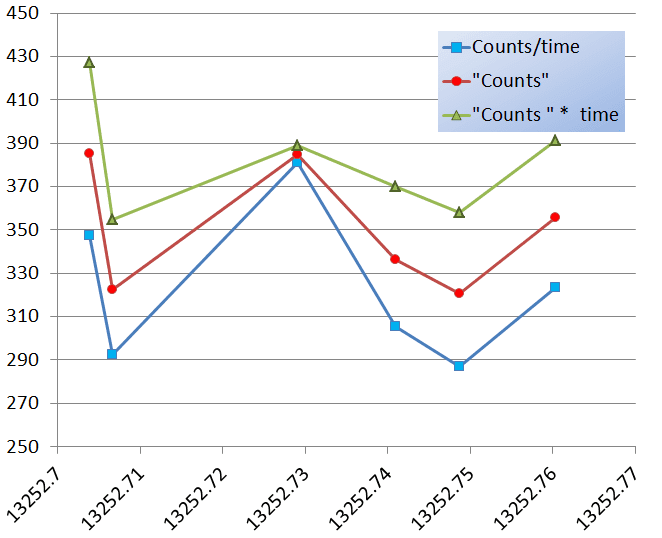

I am sorry, yes I meant rate (to get counts multiply the first 2 columns, my bad!). Also I have few tens of thousands of points between 13252.3231 and 13293.9497 ##cm^{-1}##. Here I provided some randomly selected points just to give an example the kind of data that I have, but there is a peak when you plot everything (and you have something around 2000 counts around that freq value). So one of the reasons to merge bins, is that there might be an error associated with the freq measurement, so if I say 13252.74, if there was a miss reading, that might be actually a count belonging to 13252.75 or 13252.73. If we merge several bins, average the frequencies and quote the average as the center of the new bin (I am still not sure what kind of average would that be), we might be able to neglect that error when doing the fit. The main problem is that we know that the issue is there but we are not sure how to quantify it exactly yet. So averaging over several energies (assuming that the error goes like ##1/\sqrt(N)##) the error on each freq should be small enough such that we can ignore it. Also we are pretty sure that there is no fine structure in the peak, so doing this average should not hide some physics from us.

I made some clarifications in a post after, those are rates, not counts, I am sorry. So we used a laser to ionize some molecules and counted the number of ionized molecules for each laser wavelength. The laser (Ti:Sapphire)
wavelength was adjusted with a predefined schedule and when the wavelength was changed, the change was of about 0.02 ##cm^{-1}##. As I said above, we have some issues with reading the exact wavelength of the laser so 13252.7038 and 13252.7067 are probably the same value (which one of them is right, we don't know for sure), while 13252.7291 is the one after the increase by 0.02 ##cm^{-1}##. This is the raw data that we have from the software (including the decimals provided). As I said, this uncertainty about the actual freq, is the main reason why we want to do a rebinning.
Don't rebin -- no reason. And show the plot -- I sure hope the peak isn't at 13252.7 :rolleyes:

As I said I can't post my data. Also that peak is visible without rebinning, I am worried that the uncertainty in the freq measurement would add to the error of the actual peak center and I am not sure how to account for that yet.
Wouldn't worry. Do the fit and look at the errors it comes up with. Rebinning should not affect the results and certainly shouldn't improve them.

So basically, whether the error on the freq is significant or not, rebinning will not help?
You will need a reasonable estimate of the frequency uncertainty and combine it with the fitting uncertainty. As for significance it seems that you cannot determine if a change in frequency is actually a change if that is so I guess that the uncertainty would be it is close to the increment that you are making.

I do not know what you are looking for or what you expect to see, but looking at the plot of the rate vs wave no. I see no peak only an outlier data point.
