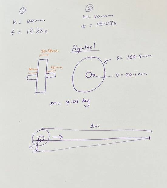

I am stuck on what to do to calculate the inertia of a flywheel using the method described.
I am supposed to use conservation of energy equations to calculate the inertia.
I have a picture of the experiment and also the measurements I have taken.
It seems each method I try I get a different number for Inertia.
Any help on how to tackle this problem would be greatly appreciated.

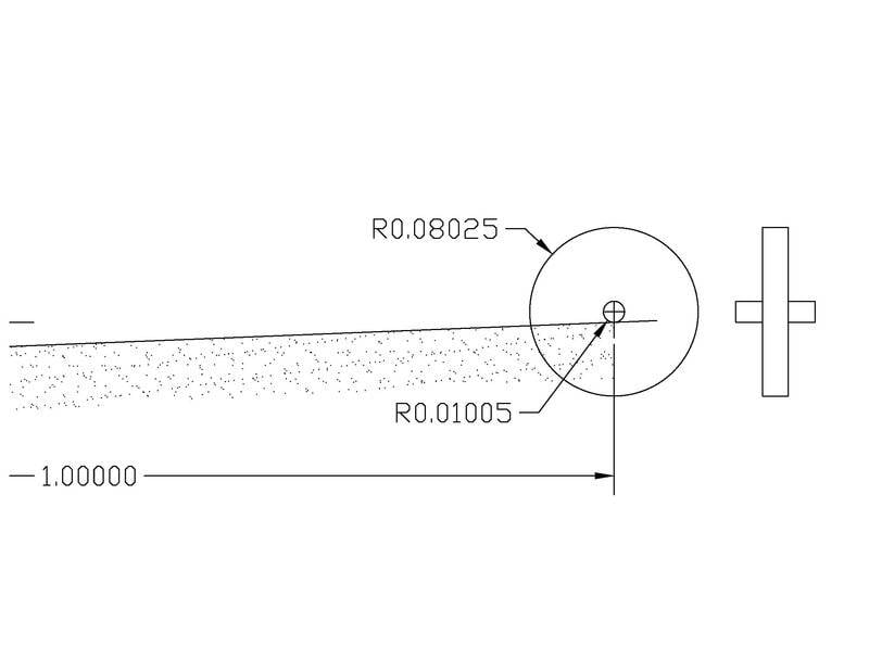

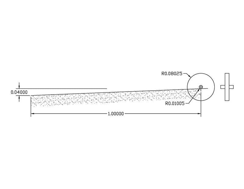

Perhaps irrelevant, but I believe that the complete shape of the flywheel (one disc and two journals) should be considered.
The above calculation of the moment of inertia is actually for a simple disc of wider dimension, resulting in a higher value for I.
Please, see:
http://hyperphysics.phy-astr.gsu.edu/hbase/mi.html#mix

Amazing graphic of the problem, thank you for that. I will have a read of that
